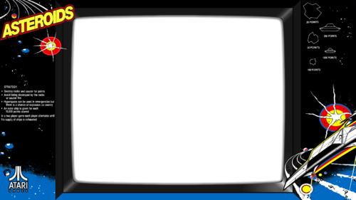

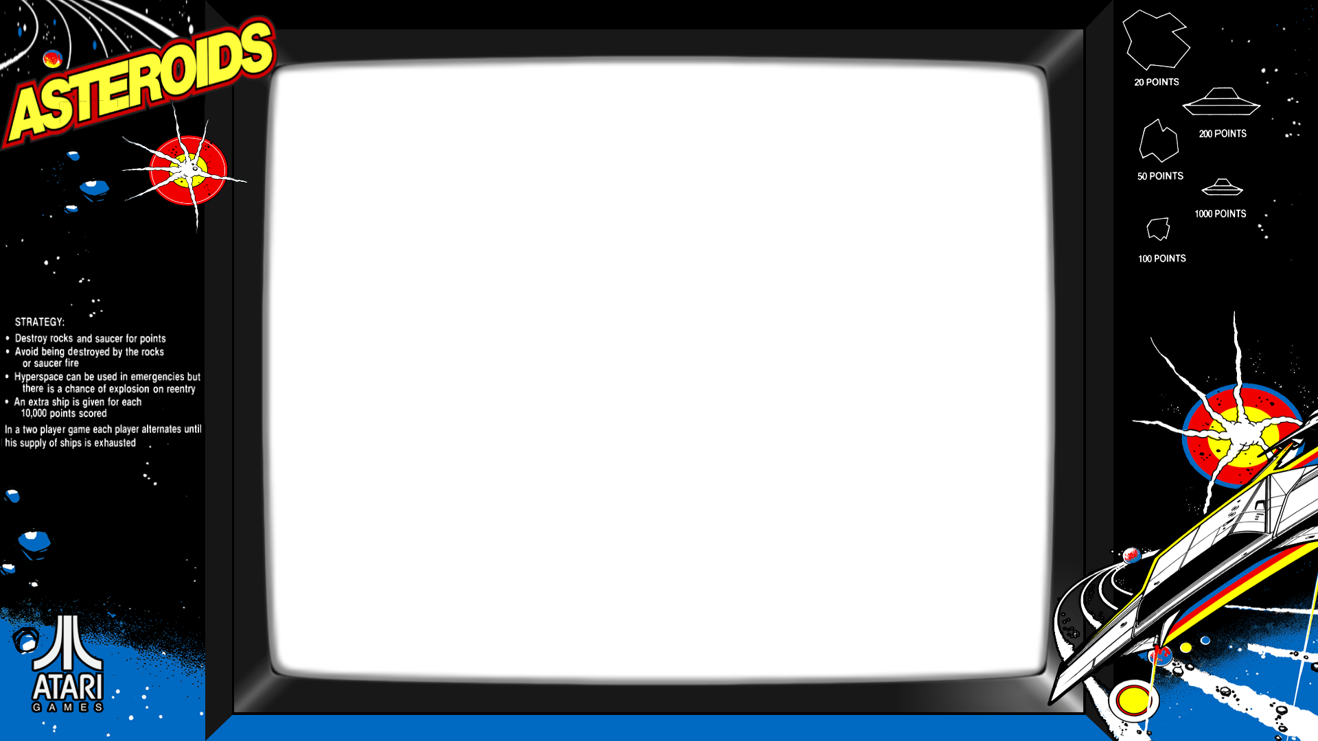

glennefj Posted October 15, 2020 Author Posted October 15, 2020 It’s the unified bezels from EmuMovies. I can upload when I get back. If I renamed the background to “Bezel” and removed all other bezels, then it would be displayed correctly over the whole screen. But I had issues loading because you would see the default bezel load in first, and the the top one. Is there a way to make that transition a bit smoother?
glennefj Posted October 15, 2020 Author Posted October 15, 2020 It is indeed the "Metalzoic" set. I'm not sure exactly what I need to configure, but I like it when it looks like this: The only problem when I rename it to "Bezel" and delete the rest, is that it will load default bezels, then this 1-2 seconds after. It looks a bit messy when starting. But it also seems like a lot of work if I have to fix it? I don't quite get it either - this background has both art + bezel in one...? asteroid.zip
Spawk Posted October 15, 2020 Posted October 15, 2020 Yes bezel is part of the background on this, a trend that continued, why have two pieces instead of just one? It all gets drawn over the game window anyway. did you rename one of the ini files to "bezel" as well? I had to (i am using RA if that matters) That's all you need is the 2 files named bezel, the rest can go. You can also play with the numbers a bit to get the scores to show better and stuff. I gotta say , I am not a fan of these bezels with the extra little dimensions going on. I wish the frame extended out to the edges like the hundreds of other bezels I have. Maybe I will tackle it one day.

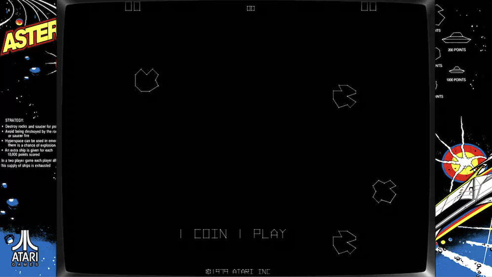

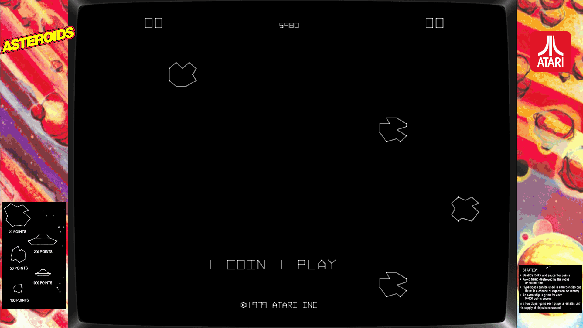

Spawk Posted October 15, 2020 Posted October 15, 2020 LOL, you just inspired me to do a quick mock up. None of the artwork is mine, it's all taken from existing bezels and whatever I could find on google. I hope nobody minds. What do you think of this:
glennefj Posted October 15, 2020 Author Posted October 15, 2020 I guess I need to test some more. I definitely liked your version!! I also want to test with overlay on Space Invaders, I haven’t quite figured it out yet, but it looks cool. I did not create an ink file, and it did work fine, I was just confused why some were like your versions, while others were hidden behind the bezel. I guess I agree with expanding game area vs large bezel, but then being cut looks weird.
