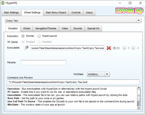

JrobATL Posted January 2, 2021 Author Posted January 2, 2021 Thanks for the reply. It doesn't seem to be the video. I renamed it to another rom, and it previews fine. I also added Crazy Taxi to the Mame.xml, and it previews it fine in the Mame subwheel, but of course can't load it there. Attached is my Wheel Settings snapshot. Any other ideas?
Spawk Posted January 2, 2021 Posted January 2, 2021 Oh I see you are bypassing RL altogether... interesting. If you use the PC launcher module in RL it will open back up the rom path and extension options in HQ. I assume it would work then.Sent from my iPhone using Tapatalk

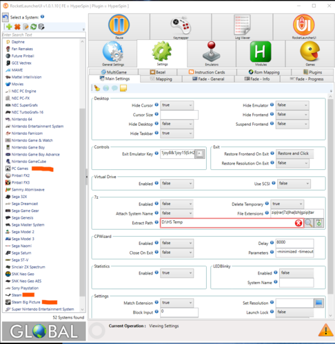

JrobATL Posted January 2, 2021 Author Posted January 2, 2021 Ahh... crap. I was afraid it would be that. For some reason, PC Games wasn't listed in RLUI's systems, and when I tried to create it, I couldn't get it to work (I have a post on RL forum about pclauncher.ahk that is still looking for help, I think). That's why I ended up with this workaround. Do you think if I reinstall RL, the PC Games system would show up, or is there a proper xml file I can look at to add the PC Games system properly? I've been thinking about trying to get the PC Games system to work, because some of the Steam games I'd like to play on my cab would require some type of key remapping, or VJoy, I believe.
gigapig Posted January 2, 2021 Posted January 2, 2021 7 hours ago, JrobATL said: Ahh... crap. I was afraid it would be that. For some reason, PC Games wasn't listed in RLUI's systems, and when I tried to create it, I couldn't get it to work (I have a post on RL forum about pclauncher.ahk that is still looking for help, I think). That's why I ended up with this workaround. Do you think if I reinstall RL, the PC Games system would show up, or is there a proper xml file I can look at to add the PC Games system properly? I've been thinking about trying to get the PC Games system to work, because some of the Steam games I'd like to play on my cab would require some type of key remapping, or VJoy, I believe. PC Games should show up as a system just like Steam and Steam Big Picture should. Open the module and all the supported systems of the PCLauncher module will be at the top. Make sure they are spelled exactly right.
JrobATL Posted January 2, 2021 Author Posted January 2, 2021 5 hours ago, gigapig said: PC Games should show up as a system just like Steam and Steam Big Picture should. I agree it should show up. Any suggestions as to why it's not, or (more importantly) how to get it back?
gigapig Posted January 2, 2021 Posted January 2, 2021 22 minutes ago, JrobATL said: I agree it should show up. Any suggestions as to why it's not, or (more importantly) how to get it back? I did suggest you spell them correctly. If in doubt look in :\HyperSpin\RocketLauncher\RocketLauncherUI\Media\Icons

JrobATL Posted January 5, 2021 Author Posted January 5, 2021 I appreciate everyone's help. I should clarify that I would actually prefer to have my Steam games and PC games run from a PC Games wheel, but the PC Games module did not appear by default in the list of systems in RL and when I tried to create it, I wasn't able to get it to work. So I put my PC Games on the Main Menu as a workaround. I'm going to try to reinstall RL and see if that fixes it. Meanwhile... and I know you guys are going to hate me for this, so I sincerely do apologize... but regarding the Steam game videos that wouldn't load... I hadn't downloaded any themes for those games. I just started with downloading the videos and seeing if they loaded on the Main Menu. I had assumed that the Mame theme would just carry over like it does in the Mame subwheel and play the relevant video (I know, I know). I downloaded a theme for the only Steam game I had that I could find and it's video loads now... So no theme, plus the fact that they're on the Main Menu was clearly my problem. But a sincere thanks to you both, because I wouldn't have kept going to see if it would work without your replies.
