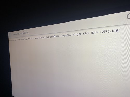

3.  The config file is pointing correctly

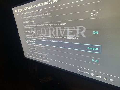

4.  I load up a game for said system.  It doesn’t load the bezel, it loads a default bezel.
5.  No matter what I do, if I change that bezel, it becomes the default bezel for every core.
how do I set per core directories so each core I can direct to said folder in my overlay folder ( overlay/snes) etc.
this is super frustrating.
RA is a finicky bitch... Load a core and a game, then apply the overlay you wish to use for that core. Then save a "core" override!
You can do this by "game" as well but you would have to load every game, and save "game" overrides.
Man there has to be a diff way no? Per game would take years to do.
I have every config of every game  pointed to the correct folder and overlay.  It’s done correctly,  as seen below.
Yet every game I load, it’s met by this default MAME overlay for “Assault” even if a load a completely different system (nes etc)
