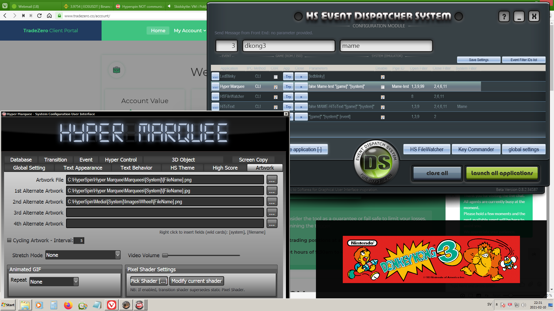

Rockme Posted February 10, 2021 Author Posted February 10, 2021 Thanks for the reply! I dont know exactly what settings you require, but I have attached a pic. As I said, Hyper Marquee works with EDS when I test it. I can make different marquees appear by changing the rom game name, so all things seem to be working fine. But when I start Hyperspin and run a game, the marquee does not change (nothing happens), even if I try the same games that I know works fine with just EDS + HyperMarquee.
Rockme Posted February 10, 2021 Author Posted February 10, 2021 Yes, I did. I have it in this directory: C:\Program Files (x86)\AntosSoft\EDS Installer Setup\

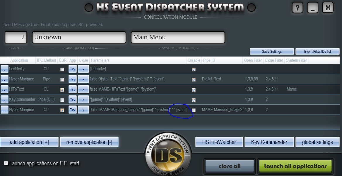

Spawk Posted February 10, 2021 Posted February 10, 2021 You have Ledblinky disabled in EDS. I think this is how it communicates so it must be on even if you have no buttons to light up.
Rockme Posted February 10, 2021 Author Posted February 10, 2021 Enabled it, but it didn´t make a difference unfortunately... When I start a game in Hyperspin the game loads and runs fine, but HyperMarquee doesn´t work.. strange!!
Spawk Posted February 10, 2021 Posted February 10, 2021 Yeah I guess you are suppose to point to your "real" Ledblinky there??? Sorry just learning this stuff as well.
Spawk Posted February 10, 2021 Posted February 10, 2021 Works for me with almost the exact same settings as you... only difference I see is the "event" parameter with the extra quotes in there:

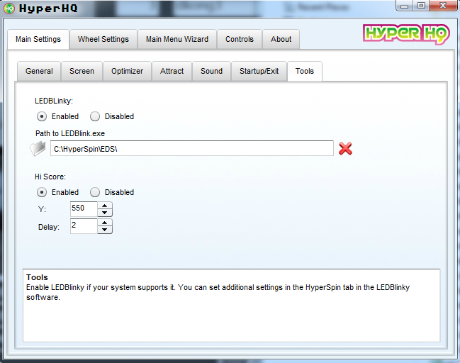

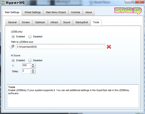

Rockme Posted February 11, 2021 Author Posted February 11, 2021 FIXED IT!!! I found out that I had not enabled LEDBlinky in HyperHQ, that was the problem! Now it works, and I don´t have to have LEDBlinky enabled in EDS (in my case I don´t have need for it). THANKS A LOT to you guys, you really helped me out quickly with this!! :-)
