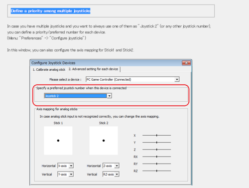

I've run into an annoying issue. When ever I reboot my computer, the joytokey mapping I have setup,  changes. Each joystick settings move and I have to open joytokey and update the joystick to the corresponding mapping setting. Than I also have to edit RocketLauncherUI joytokey settings. Just curious if there is a way to lock the mapping.
This is not an HS issue really, it's a "Windows" issue. It will randomly assign ID's every boot. RL does have "preferred controller" and "custom names" settings that can help though. Unfortunately RL isn't loaded until you select your first game. I suppose you could set HS navigation on all joypads so it doesn't matter which one is P1. Then soon as you start a game RL will order them to your liking.
Im not in front of my arcade PC so apologies for my vague response but there is a way to fix this within JoyToKey.  If memory serves me correctly you can select a set controller for each joystick profile so that the windows order doesnt matter.
