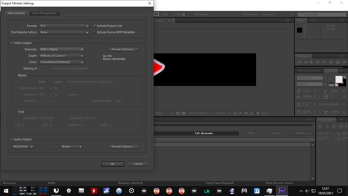

Kid80 Posted May 17, 2021 Posted May 17, 2021 Hello dark13, I introduce myself I'm Kid_ITALY, for friends just Kid ... So basically I start by telling you that you are very good at using animation programs. I am working on your old but beautiful project for me (On this Video of yours: https://www.youtube.com/watch?v=eWpqa6Y6vTA ). In practice I would like to ask you what program you use to convert the video with Video image from above to .FLV format, which in practice my problem that I find that image is not very clear when I send the Video from below, sometimes it creates borders for me around blacks, it is in fact this problem should not happen. I kindly ask what program you use to convert and what settings you bring to get a clean image. Thank you very much if you could give some advice on how to proceed and continue on your program and of course I would like to propose it in the ITALIAN version. I await your news .. Thanks.
dark13 Posted May 18, 2021 Posted May 18, 2021 I did the video in After Effects CS6. CS6 as later versions don't have .flv encoder. Technically .mp4 supports alpha trasparency but I haven't found a software capable of doing it. You must set the thing to encode in .flv with RGB+Alpha to get trasparency. If you have other questions you can send me a message so we can use italian instead of english or post in the italian section of the forum Automatizing infopanels creation from .csv files for HTPCs themes (look at infopanel tutorial.zip on the ftp in dark13 folder) PNGs to SWFs automatized flash scripts Hyperspin Wheelset automatized template (photoshop's variables + batch) Aeon nox 4.13 W.I.P. hyperspin skin
