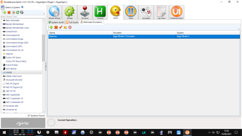

dark13 Posted June 14, 2021 Posted June 14, 2021 You can do it but you must use RocketLauncher. Add the games in MAME.xml then use "alternate emulators" feature in RL to map those roms into another emulator (you must set NAOMI too into RL and HS, you can then delete NAOMI wheel from "Main menu.xml" so it will not appear in HS. Automatizing infopanels creation from .csv files for HTPCs themes (look at infopanel tutorial.zip on the ftp in dark13 folder) PNGs to SWFs automatized flash scripts Hyperspin Wheelset automatized template (photoshop's variables + batch) Aeon nox 4.13 W.I.P. hyperspin skin

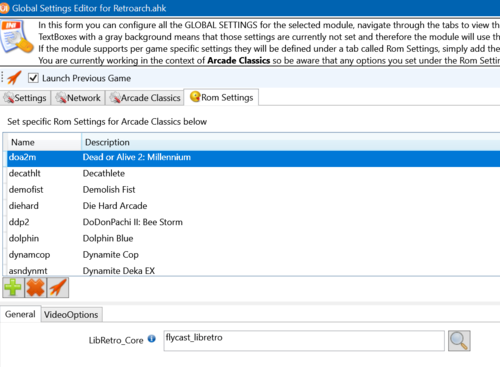

Aorin Posted July 11, 2021 Posted July 11, 2021 I have the arcade machines into one wheel, MAME, Model 2 and 3, Naomi, Atomiswave and a few newer titles like Daytona 3, Sega Rally 3 etc, the system is called Arcade, in the case of Atomiswave and Naomi, you can use the Retroarch's module to specify what core you want for a given game. Decathlete below Dead or Alive 2 uses the Kronos for STV arcade (Retroarch core) and so on. But for other systems not emulated by Retroarch like Model 2, 3, etc, the Alternative Emulator tab is the only way to go for now. Aorin
