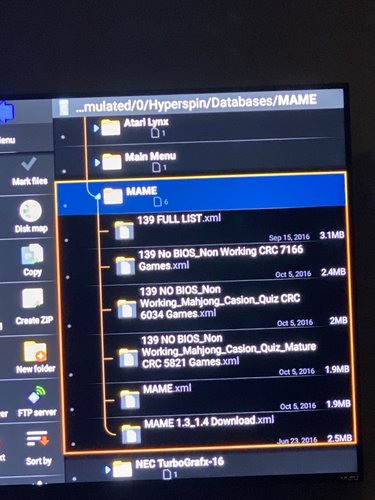

thenoob Posted August 21, 2021 Posted August 21, 2021 So looking at the file structure , do I just create a folder in the database folder called Final Burn Neo, and add a FBN .xml file? Do I need to add neogeo bios also in this folder? going through all the other systems and seeing it’s just an .xml to add the system correctly. The. Obviously adding media/theme etc. Newest version of RA plus is FBN and not FBA , just making sure FBN can be added to android HS and where the bios goes.
