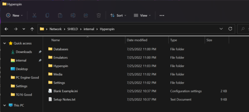

To date, all I have done is loaded the .apk into my downloads folder (from this thread on to a PC, then moved to the Shield via my local network), created a “Hyperspin” folder at the root level (Shield—>Internal—>Hyperspin… since I’m using internal/extended storage, not external), and then launched the install from my downloads folder. I’m in developer mode, btw.

Ok, despite having done a fair number of Hyperspin builds in the past, I'll admit this is the first time I've done it on Android, and some basic things really threw me. But the MOST basic of all is that you have to have the Android Base Pack installed FIRST! Simply creating folders isn't enough... Hyperspin wanted all of the assets and ini files, which makes sense, in retrospect. So, for me, here's what that looked like when I was done (I'm looking at my Shield through the network connection on my PC... I placed the Hyperspin apk in the Hyperspin folder and installed it from there, but I'm not sure if that matters or not):
The part that got me off track is that the instructions on this page said, "But First..." and then it proceeded to talk about where to create folders, getting a file explorer, and eventually launching the app. Some of this (in my mind) should have predeed the Base Pack instructions, since it looks like it's telling you to do all of this setup before you get the Base Pack, when in reality, that's part of the Base Pack guide. Anyway, it may have just been my reading of it, but it threw me.

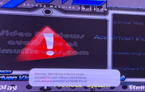

All that said, when I try to actually get MAME4droid to open through Hyperspin, I get an error:

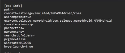

Now, I used the exe that was already in the MAME.ini file from the official Hyperspin Android Base Pack (which is the same as what's shown here for MAME:
Any ideas what might be causing MAME to return that error, @reznnate
Weird! I’m using MAME4droid, but I’m guessing it’s the same issue as yours, @reznnate.
Even if I get nothing else working, MAME (arcade) is the one emulator I always run with Hyperspin, so it would be a deal-breaker if we can’t get it going. Let me know if/how I can help!
