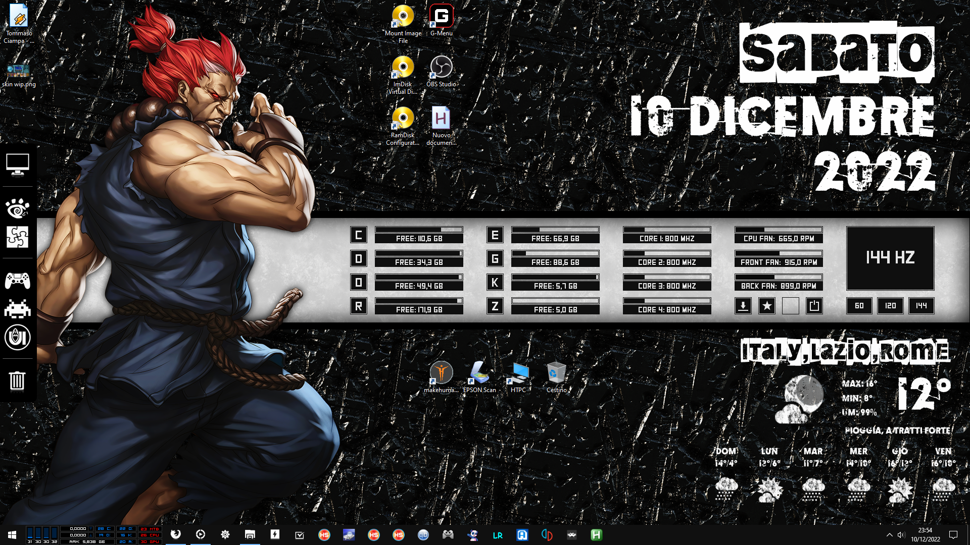

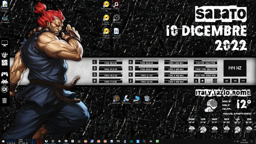

dark13 Posted December 10, 2022 Posted December 10, 2022 Can't find the .bat used in the cabinet but this ahk should be better, i use it to close all widgets I'm running. A quite busy desktop... Automatizing infopanels creation from .csv files for HTPCs themes (look at infopanel tutorial.zip on the ftp in dark13 folder) PNGs to SWFs automatized flash scripts Hyperspin Wheelset automatized template (photoshop's variables + batch) Aeon nox 4.13 W.I.P. hyperspin skin
