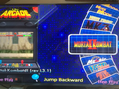

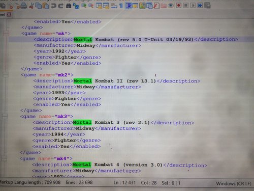

mikty Posted June 4, 2023 Posted June 4, 2023 Hi, I encounter a strange behaviour on mame wheel. the wheels doesn't follow the order of my xml databases. I used to manage xml with notepad and exel in order to rearrange the order of titles to be the more logic possible. for exemple, I would to order the mortal combat series title and wheels as below whitch seems to be the best order: mortal kombat mortal kombat II mortal kombat 3 mortal kombat 4 So I order in my xml these order but my wheels still show a different order (because of the "II" instead of "2") (see pics below). Is there any tips to keeps original title without rename it and keep the order given ? thanks for your help and support regards
floatingyeti Posted June 6, 2023 Posted June 6, 2023 Unfortunately, order is determined alphabetically by the description. No matter what order the database is in. You would have to change "II" to "2". Your wheel and theme would still have the correct "Mortal Kombat II" Sometimes you have to make odd choices in the description so games will display in correct sequence on the wheel.

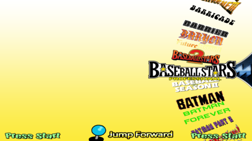

Andyman Posted June 6, 2023 Posted June 6, 2023 This is interesting, because I set up my cabinets' databases with the games in the order I want them displayed in the wheels, and they're displayed in the exact order I have them listed in the database. For example, Baseball Stars Professional displays before Baseball Stars 2. I also can confirm my setup isn't ordered by the <game> field either, as bstars2 displays before batman. I don't remember changing any settings pertaining to this, but it's been awhile. Also, I just looked through various .ini files and didn't see any relevant settings, so...? It's a mystery.
floatingyeti Posted June 6, 2023 Posted June 6, 2023 8 hours ago, Andyman said: Baseball Stars Professional displays before Baseball Stars 2. I also can confirm my setup isn't ordered by the <game> field either, as bstars2 displays before batman. That's because it's ordered by <description> "game name" </description> You are referring to <game name="rom name"> I want to be wrong about this limitation because it's very inconvenient. I've encountered many irritating examples in the databases I made.
Andyman Posted June 6, 2023 Posted June 6, 2023 I just did a little test, to check... Baseball Stars Professional before Baseball Stars 2 in the database = Baseball Stars Professional displays first. Baseball Stars 2 before Baseball Stars Professional in the database = Baseball Stars 2 displays first. So, it definitely can be ordered to your liking... I'm just not sure how I got mine to work this way. haha
floatingyeti Posted June 7, 2023 Posted June 7, 2023 2 hours ago, Andyman said: So, it definitely can be ordered to your liking... I'm just not sure how I got mine to work this way. haha my database: <game name="bstars" index="" image=""> <description>Baseball Stars Professional (NGM-002)</description> <cloneof /> <crc /> <manufacturer>SNK</manufacturer> <year>1990</year> <genre>Baseball</genre> <rating>Other - NR (Not Rated)</rating> <enabled>Yes</enabled> </game> <game name="bstars2" index="" image=""> <description>Baseball Stars 2</description> <cloneof /> <crc /> <manufacturer>SNK</manufacturer> <year>1992</year> <genre>Baseball</genre> <rating>Other - NR (Not Rated)</rating> <enabled>Yes</enabled> </game> Unfortunately for me its alphabetizing the Wheel in reverse order to my database Its putting "2" before "P" Baseball Stars 2 Baseball Stars Professional How does your database look? What settings do Mikty and I have to adjust so our databases will be arranged in xml entry sequence rather than <description>?

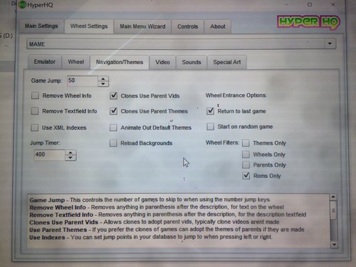

Andyman Posted June 9, 2023 Posted June 9, 2023 OK, I just did some more testing on a brand-new install of HyperSpin 1.5.1. Here's what I found: Unaltered fresh install: Games are ordered alphabetically. Nothing you do to the XML database changes that. Copy only Settings.ini from my setup: No change, same as above. Copy only MAME.ini from my setup: Result! You can order the XML however you like, and it'll display the games in that order! Hmm... OK, so there's something in my MAME.ini that lets you order the games as you like... so I set about fiddling with MAME.ini until I figured out what that was. (I literally laughed out loud when I discovered it...) Under [navigation], "use_indexes=false" is the default in the installation package. With it set to false, the ordering is alphabetical and automatic. However! Changing this setting to true allows the XML to be displayed on-screen in the exact order it's laid out, top to bottom. I rearranged a bunch of things, just to be sure. It stuck how I laid it out each time. I can only assume nobody's noticed this because nearly all of the XMLs we use are already alphabetical. Changing "use_indexes=" wouldn't have any visible effect unless you also change the order of the games in that system's XML database. And here, all this time, I thought "use_indexes=" determined whether you could use the Letters indexes or not (by holding the left or right arrow keys). When in fact, the setting has no effect on that feature at all. ... TL;DR: Under [navigation] in a system's .ini file, set "use_indexes=true" and you can order your setup however you like. Mystery solved. Enjoy!

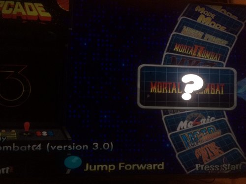

mikty Posted June 10, 2023 Author Posted June 10, 2023 Hi, thanks you so much for your discovery about xml order. At the first attempt, this settings doesn't work because I see in my mame.xml that each line " index="" image="" " isn't present, so I manage to add them into my mame.xml and it works now thanks. The only annoying effect is that I can't use anymore the letter research (A,B,C ...) with hold the left or right stick. I have an interrogation point instead (see pics) do you have the same problem ? thanks again for your reports and your great discovery regards
Andyman Posted June 10, 2023 Posted June 10, 2023 To use the Letter indexes, you must have them included in your XML. Generally, you set index="true" and image="a" to the first game beginning with A, for example. If you don't have any indexes set, you'll get the question mark when you try to use the Letters. It will also do strange things if you have multiple entries of the same letter in the XML.
