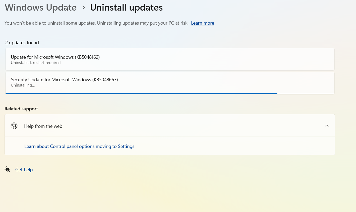

Drummy Posted December 7, 2024 Posted December 7, 2024 Thanks for the useful info Creezz67. Maybe not ideal, but I can confirm that by uninstalling KB5046740 update from Windows 11 Pro 24H2, Hyperspin does seem to work again. 1
Creezz67 Posted December 7, 2024 Posted December 7, 2024 58 minutes ago, Drummy said: Thanks for the useful info Creezz67. Maybe not ideal, but I can confirm that by uninstalling KB5046740 update from Windows 11 Pro 24H2, Hyperspin does seem to work again. I must admit I got that info from elsewhere as when mine went down I took a screenshot of problem update, then lost everything on my new SSD when trying a system restore, so didn't see the code. I thought the one that caused the problem for me could NOT be uninstalled (I checked) and it was a large Security preview update and the only one that updated on my PC on a fully working 242H setup i had just installed (meaning Hyperspin was working fine on 242H until that update) Can you confirm that it's NOT working with the update, then working again when uninstalled ?
Drummy Posted December 7, 2024 Posted December 7, 2024 I can confirm that by uninstalling the KB5046740 update from Windows 11 Pro 24H2, Hyperspin does seem to work again. The screenshot below shows my system is up to date, but KB5046740 is ready for download again after I uninstalled it. 1
Creezz67 Posted December 7, 2024 Posted December 7, 2024 22 minutes ago, Drummy said: I can confirm that by uninstalling the KB5046740 update from Windows 11 Pro 24H2, Hyperspin does seem to work again. The screenshot below shows my system is up to date, but KB5046740 is ready for download again after I uninstalled it. Yes, That's the download I had, but when I checked to see if it could be uninstalled it was NOT on the list. This is a large optional update as well, so I Very odd. Try installing this and you can hide the update and it will NOT be installed again. wushowhide.diagcab
Drummy Posted December 7, 2024 Posted December 7, 2024 Thanks Creezz67. You did try and uninstall the update from Windows Update > Update History > Uninstall Updates?
Creezz67 Posted December 7, 2024 Posted December 7, 2024 19 minutes ago, Drummy said: Thanks Creezz67. You did try and uninstall the update from Windows Update > Update History > Uninstall Updates? Yes

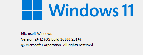

mikeandbirgit Posted December 22, 2024 Posted December 22, 2024 Its not 24h2 its just the newest version of it so i uninstalled and its working again but they still need a fix for this im still on 24h2 shown below after uninstalling lastest version of 24h2 1
Hyperaspp Posted December 22, 2024 Posted December 22, 2024 KB5046740 8 hours ago, mikeandbirgit said: Its not 24h2 its just the newest version of it so i uninstalled and its working again but they still need a fix for this im still on 24h2 shown below after uninstalling lastest version of 24h2 KB5046740 <==== Its this update
