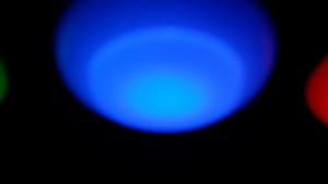

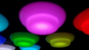

sevenseal Posted November 12, 2014 Posted November 12, 2014 the cx (convex) is the round top while the regular (concave) is the press down surface to fit your fingertips in... it all really what you prefer in your play style.. I will take picture later... I have both them convex with true-leaf pro for my system buttons and concave with microleaf for my players buttons

sevenseal Posted November 17, 2014 Posted November 17, 2014 blue one is the convex button and the violet is the concave button
