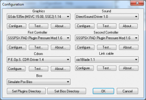

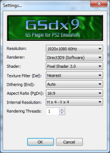

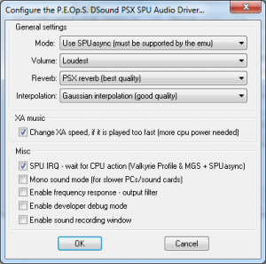

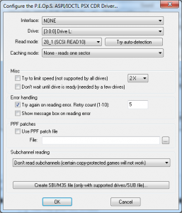

gigapig Posted August 17, 2014 Posted August 17, 2014 Here's screens of my configs. Graphics plugin, remember I'm using Sweetfx which requires DX9. The CD plugin I setup before realising that it wasn't required, so drive L is my DT Lite SCSI drive, you may be able to just leave this as default. And finally sound which is possibly the default settings. Fine tuning I've never done, so I'm not sure if you can have specific configs per game.
