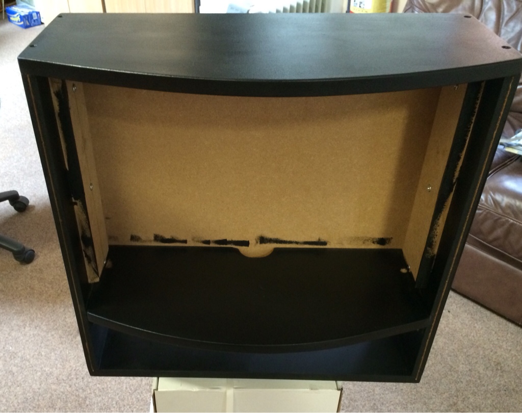

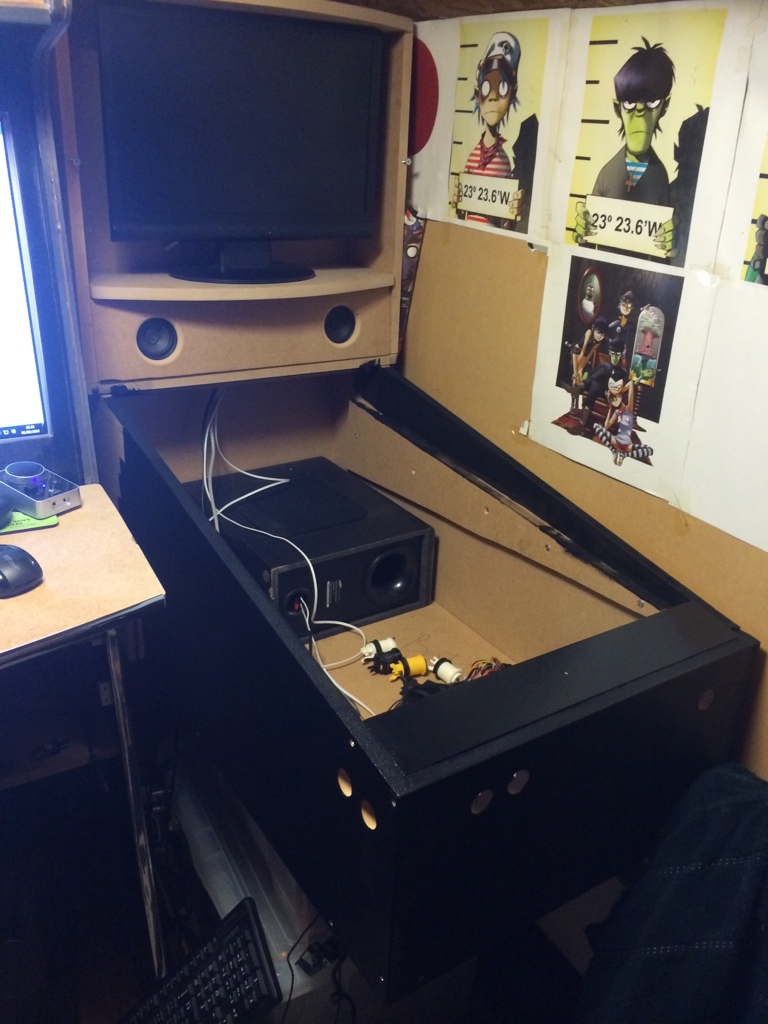

monkeychunkuk Posted September 1, 2014 Author Posted September 1, 2014 Oh and here's in inside the cab ; ) It's not pretty So tonight I was gonna just put some black paint on the side walls but I poured to much out I bought this at a carboot too for 50p It great stuff I hope they still sell it Black is the new black Sent from the smut hut

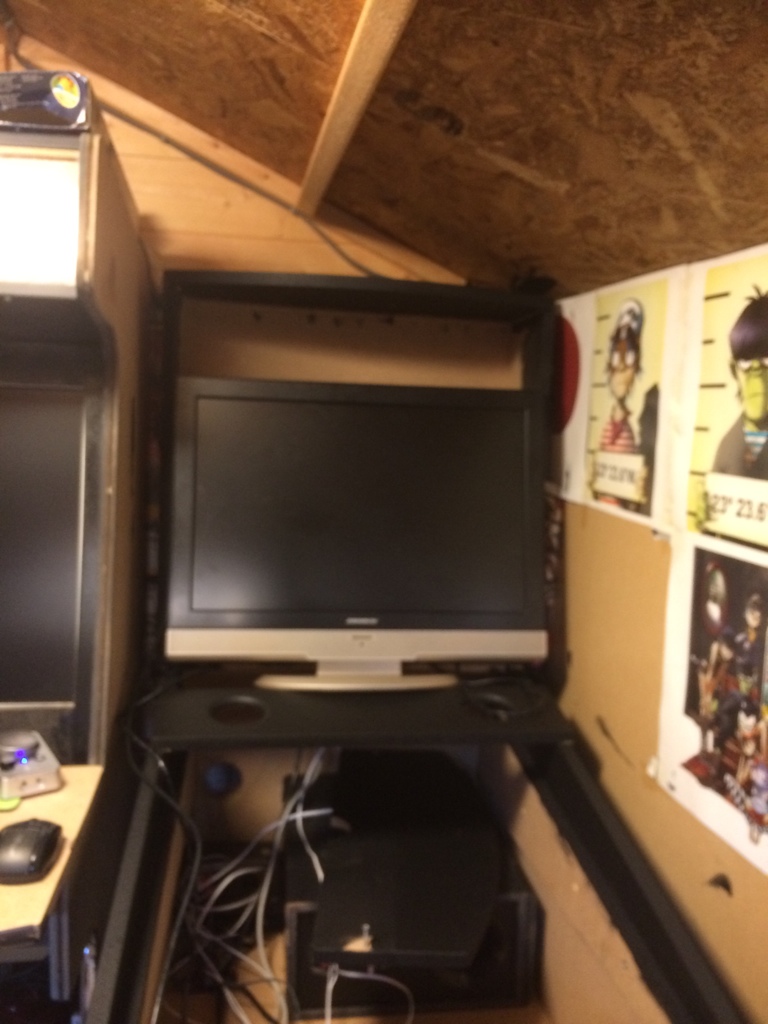

monkeychunkuk Posted September 2, 2014 Author Posted September 2, 2014 Must be my lucky day I found this "broken tv" at a job I was on And after changing the power supply fuse it worked ? Shame it's 2mm to wide otherwise I with wouldn't have to decase it ; ) Sent from the smut hut

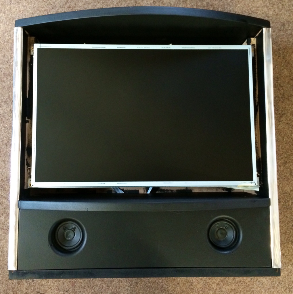

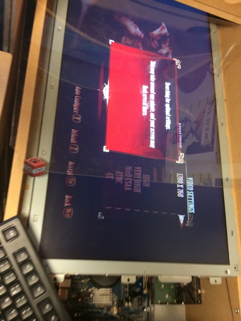

monkeychunkuk Posted September 2, 2014 Author Posted September 2, 2014 So my ram turned up one of 4gb was bad so I'm sending it back but the table run loads betters on 6gb And I fitted the new screen I had to decase it but I'm really happy it's like it was made for the back box I had to adjust the screen using the scroll lock is their a option or a config I can copy to all table? And the dreaded screen flicker is still around when the game starts after the ball drains any thoughts ? Sent from the smut hut

monkeychunkuk Posted September 7, 2014 Author Posted September 7, 2014 Woooo I figured the screen the flicker the monitor was not set at the right resolution so it kept having to change ! Once I set it to the exact size It made the game speed up and looks even better than before

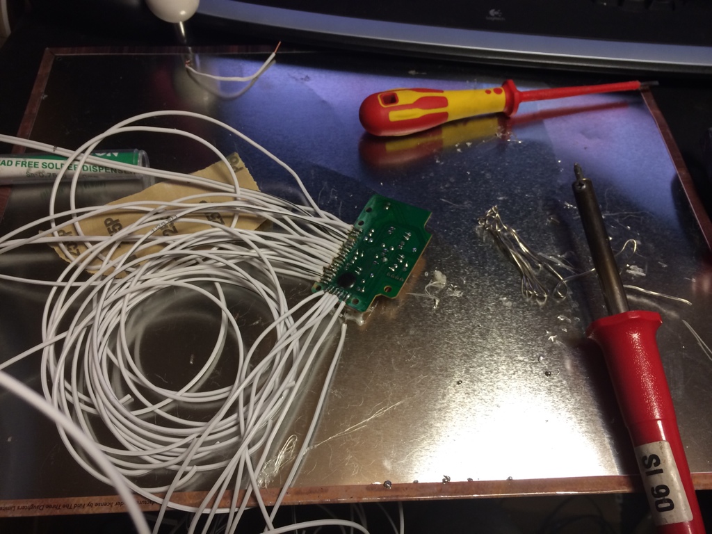

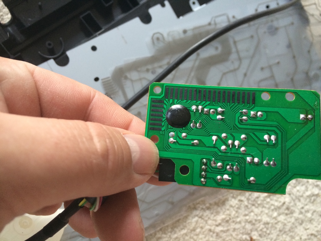

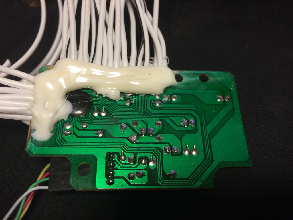

monkeychunkuk Posted September 15, 2014 Author Posted September 15, 2014 So I normally I use a ipac 2 for the keyboard encoder but with them still at £32 I was looking for a alternative,I've had hit a misses with the Xbox controller So I thought I'd bust open this Ps/2 pin keyboard, I know this isn't great for full arcades because of ghost key presses and limited to 6 keys at once,but for the pinball I'm only using 2 keys at once So I ripped the keyboard apart And I ripped this off And did a shitty job soldering onto the connection Very tricky as the connection where lead covered so I scratched it all off to get something to solder to And then I coverd the sins with my glue gun ; ) And amazingly it still works All I have to do is figure out the wire cross connections to get the keys I want It's really slow work Sent from the smut hut

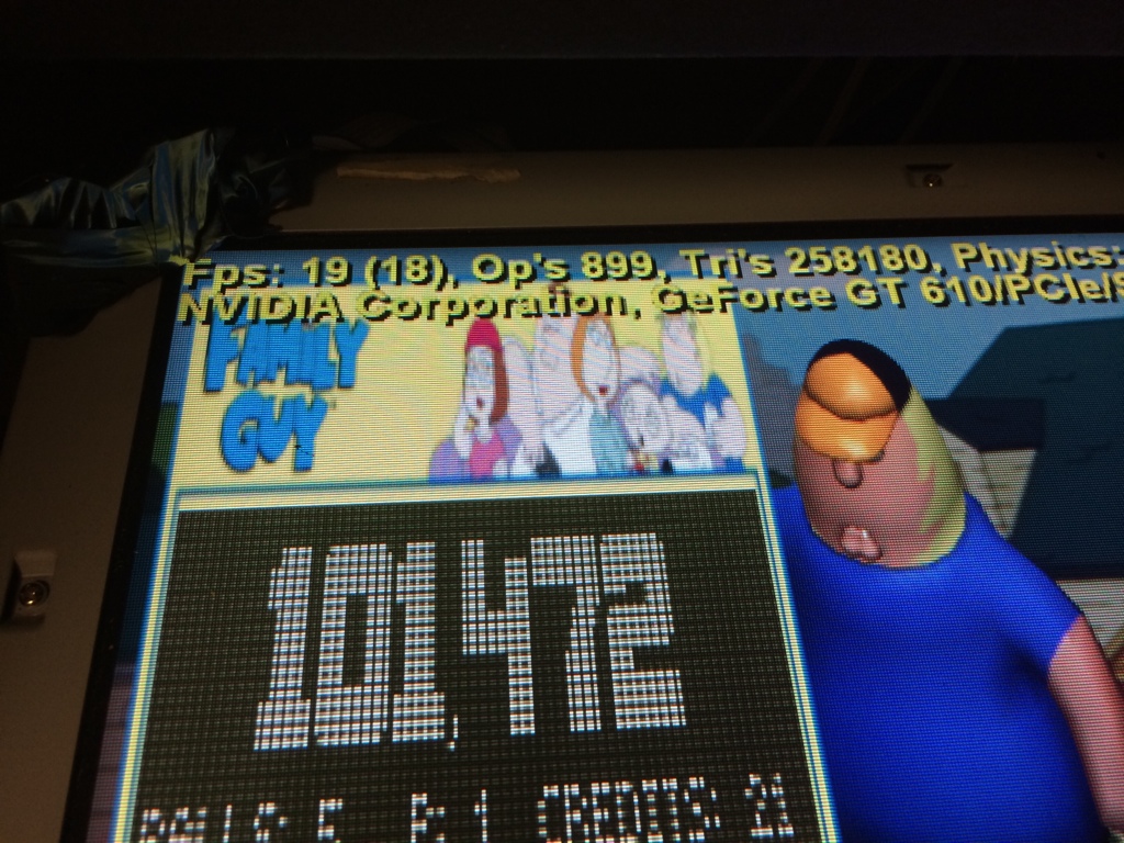

monkeychunkuk Posted September 15, 2014 Author Posted September 15, 2014 hmm sooo i put in a new hard drive and im trying to config future pin etc, and i noticed the table plays better that cant be the different hard drive right???? new 80g laptop hdd ( of course the table has flicker with screen tear becuase it not set up) BUT dies it look likes its running smoother? old 500g drive (with everything set up) has this got flicker/ball jumping or am i just seeing things? sorry about the crap cam
mikekim Posted September 16, 2014 Posted September 16, 2014 the different hdd wont affect the game once the table has loaded. it will only affect the loading times of the tables and front end videos etc..
monkeychunkuk Posted September 17, 2014 Author Posted September 17, 2014 the different hdd wont affect the game once the table has loaded. it will only affect the loading times of the tables and front end videos etc.. Thanks Mike maybe it's just the config do you noticed any different ? Last night I found the Frame rate option I'll video them to see if it's running quicker Sent from the smut hut
monkeychunkuk Posted September 17, 2014 Author Posted September 17, 2014 Yup see this is the frame rate on the small Hdd. 33fps Old Hdd 19fps Same setup differ hard drive? Wtf? Sent from the smut hut

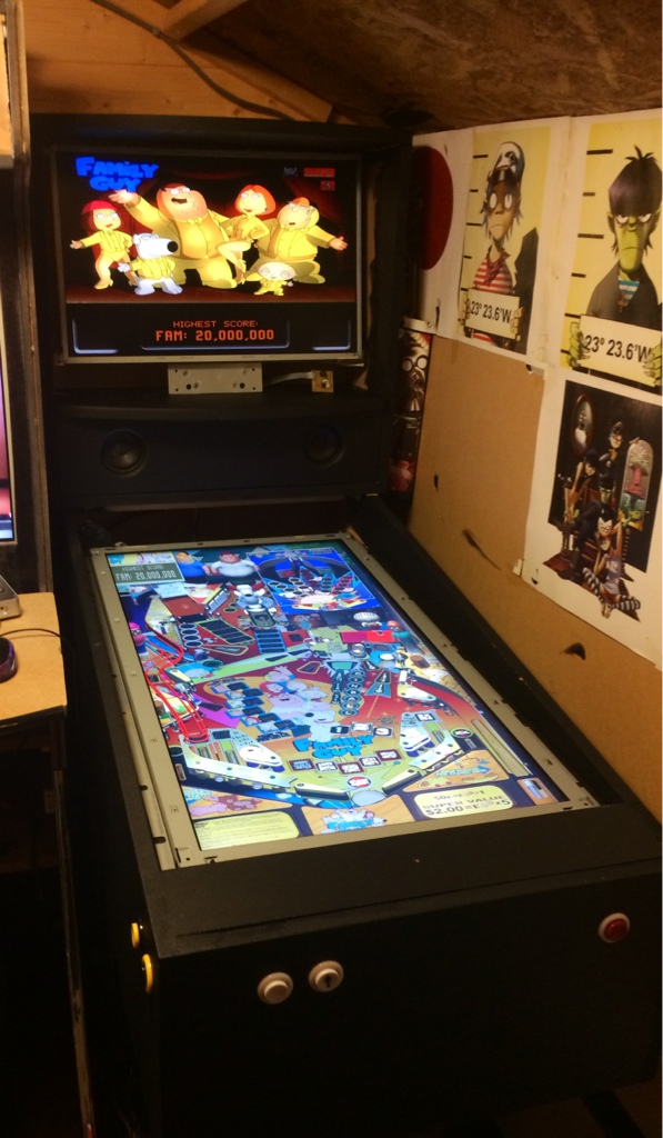

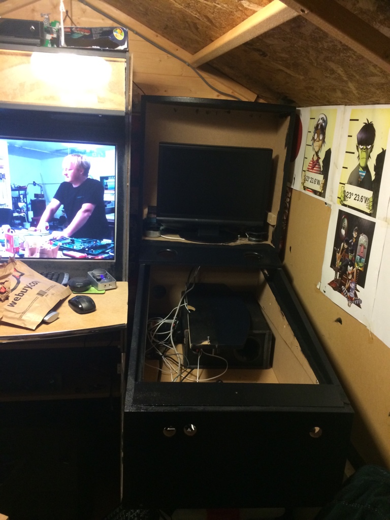

monkeychunkuk Posted September 18, 2014 Author Posted September 18, 2014 Just wondering if you were able to get some measurements of your build? The rough measurements are ok too. Hate to bother you again, but wanted to get started this weekend. Thanks Here you go sorry it's a bit crap and in inches but google will convert for you So a few things to take in count measure how wide your play field screen is after decase mine is slightly wider because it would not trim done any further,and I've got a job ahead if me to hide it The part of the machine that sits under the back box I would adjust to match the actual size so in my case 8 inches Notice my back box is equal all the way up Most increase as they get to the top like wedge shape maybe consider that for your build ? The room between the bottom of the play field screen is very tight on my machine " it has a inch from the top of the graphics card and buttom of tv that's not great so maybe add a few inches to yours? Mine is based on original plans my advice would be layout all your components and change to suit your setup Sent from the smut hut

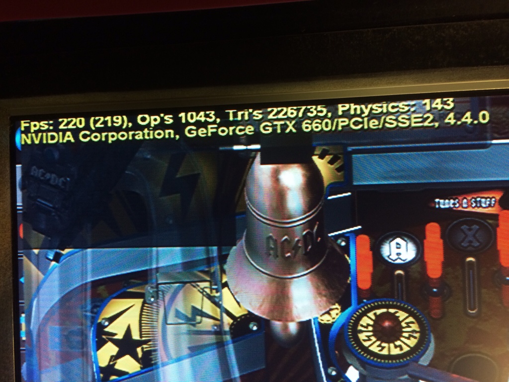

monkeychunkuk Posted September 18, 2014 Author Posted September 18, 2014 Hmmm maybe decision time I was just comparing FPS with my gaming PC and the pinball PC And it's miles apart, is it time to go back to my original idea? The games take a while to loads on the pinball config And I'm noticing a slight effect on game it's a lot smoother on the arcade but nothing "game breaking Pinball setup Arcade setup Sent from the smut hut
