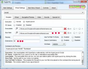

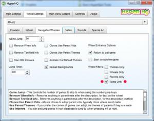

gigapig Posted August 20, 2014 Posted August 20, 2014 Welcome to the forum. You most likely have something set incorrectly in HyperHQ, which is the GUI for Hyperspin, and Hyperlaunch HQ is the GUI for Hyperlaunch. So as the problem is with Hyperspin you need to look at Hyper HQ. My guess is you have a wheel filter set and perhaps have not set the Rom path or extension. So here I have Roms only checked. So I then MUST have the Rom path filled in also, and extension so Hyperspin knows where to look and what for. With most other emulators none of that needs to be filled in if the Rom set is small and your using Hyperlaunch to launch the games, but with Mame it's different because the library is large.
