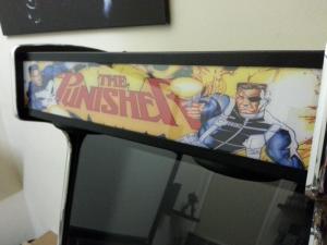

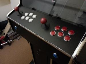

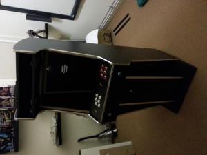

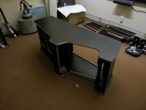

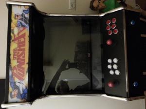

senseless Posted August 25, 2014 Posted August 25, 2014 I just wanted to share my arcade cabinet and the final results. The actual build took about two weeks and the last three to four months I invested in getting each and every emulator to work properly. The first boot was somewhere in December 2013 configured with hyperspin 1.0 and hyperHQ. In march I updated to HyperlaunchHQ. I just love the old arcade games via Mame and are now completely hooked to pinball (FP). Used I-Pac for the buttons and Pac-Drive and LedBlincky (registered) for led support. Ever since December the cabinet is used every week and even my wife is now hooked . This week I will install some custom Mortal Kombat side art and consider this project finished! I learned a lot from all you guys out there who build their own cabinet and shared their experiences and knowledge via this forum. I thank you all . Up next is my pinball cabinet which I plan to build in the upcoming weeks/month(s).
