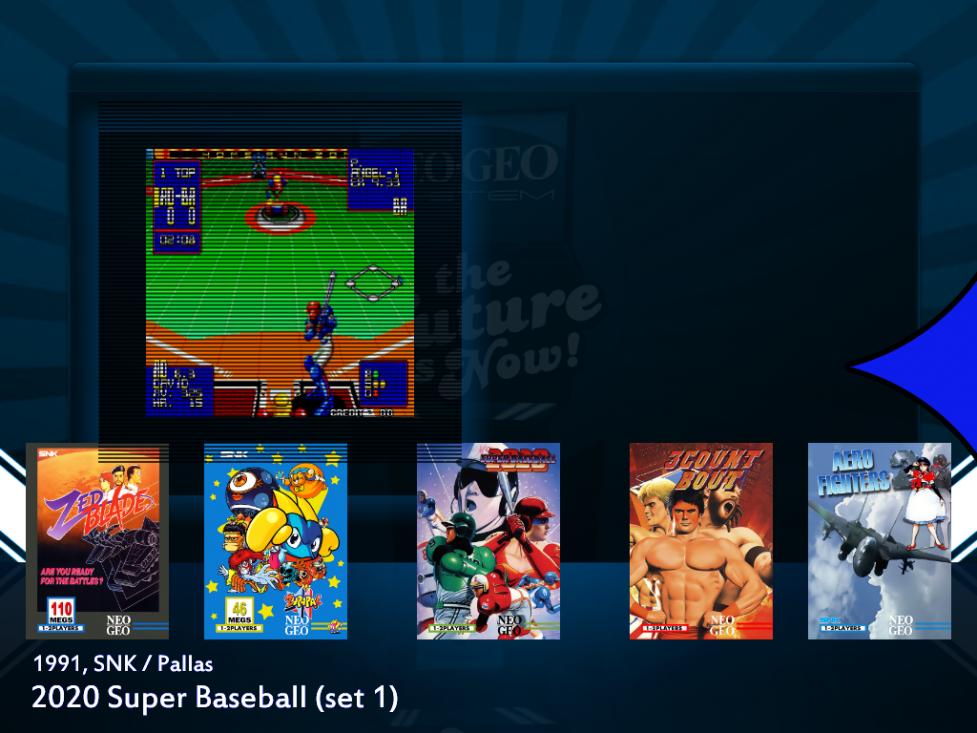

dark13 Posted August 25, 2014 Posted August 25, 2014 I'm trying to match aeon nox in hyperspin but I encountered a problem: HS does not show much info. Here's a w.i.p. screenshot I would like to have infos on the right (name, year, manufacture, conversions, etc). So the answer is, is it possibile to overlay hyperspin with a third party app to show these info from an .xml while browsing roms and systems? Probably creating .xmls would be as long as creating infos trought artwork layers BUT with .xmls based infos it would be possible to share them trought different themes only changing lines position... Automatizing infopanels creation from .csv files for HTPCs themes (look at infopanel tutorial.zip on the ftp in dark13 folder) PNGs to SWFs automatized flash scripts Hyperspin Wheelset automatized template (photoshop's variables + batch) Aeon nox 4.13 W.I.P. hyperspin skin

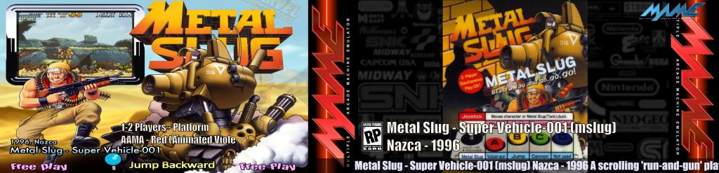

Antos Posted August 29, 2014 Posted August 29, 2014 Ok, I tried it, and it is working fine. You can overlay on HyperSpin theme. You can overlay with your own text, images and even custom themes. You will need to use Event Dispatch System (EDS) and HyperMarquee. You would will have a small Learning curve, but I can guide you. Here is a screen shot on dual monitors. (Left represents HyperSpin with text overlay from HyperMarquee (see 1&2 player + game rating) and right side my custom Marquee setup.) HyperMarquee & Event Dispatch System
