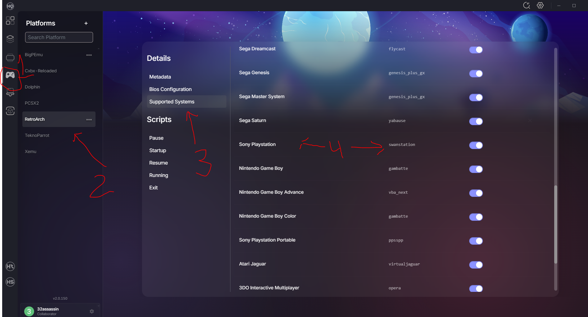

32assassin Posted Saturday at 04:50 PM Posted Saturday at 04:50 PM I had multiple systems installed and none of them worked, this was because the retorarch core was not added tot he list 1. click on Platform tab 2. click on the RetroArch tab 3. click on supported systems 4. make sure that the system you want is listed and has the core assigned to the system. I had to manually add a few PSX was one of them.

JohnnyChimpo Posted Saturday at 08:25 PM Author Posted Saturday at 08:25 PM 3 hours ago, 32assassin said: I had multiple systems installed and none of them worked, this was because the retorarch core was not added tot he list 1. click on Platform tab 2. click on the RetroArch tab 3. click on supported systems 4. make sure that the system you want is listed and has the core assigned to the system. I had to manually add a few PSX was one of them. This was needed. I enabled swanstation in Retroarch as you suggested. Now if i try and launch a PS game from HQ it tries then crashes HQ. If i launch a game from HS it goes to the spinning "loading" Hyperspin screen and never loads. I have to quit HS via task manager... Duckstation will launch the games outside of HQ/HS but I can't seem to get HQ to work with Duckstation Emulator either
