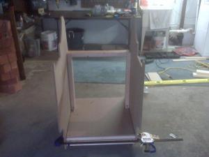

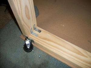

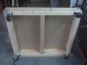

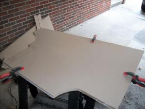

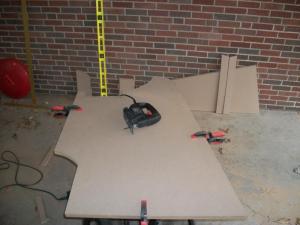

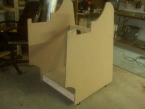

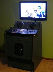

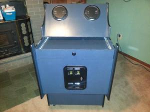

Well, here is my nearly finished pedestal cabinet. This is my second cabinet build. My first was a full size stand up cab. I wanted this one to be much smaller and easier to move around when needed.

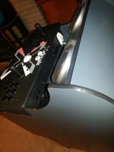

The design is my own but was loosely based on a Golden Tee pedestal cabinet. It is built from 1/2 inch MDF. It features a 32" LCD TV for the screen. It is approximately 44 inches tall and 26 inches wide. For now, I am using an X-Arcade Tankstick that I picked up on ebay for cheap. The speakers are mounted slightly above and behind the control panel. And, it has a coin mech installed.
I still have a couple things I need to finish including wiring up the coin mech and painting the inside of the cabinet but I am very pleased with how it has turned out so far. My boys love it and my wife doesn't hate it so I must have done alright. :)

Really like the look of this and it is EXACTLY what i was hoping to build for my tank stick.
Is it sturdy and does it hold the tank stick ok? It looks ace.

Yes, it's very sturdy. The Tankstick fits in place very well. It actually sits on a couple pieces of rubber that I cut out and glued down on either side so it doesn't move or slide around at all. I can always take the Tankstick apart and screw it into place or add brackets on the sides to hold it if need be but I don't think that will be necessary as it is a very tight fit.

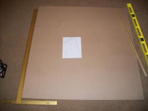

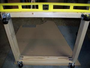

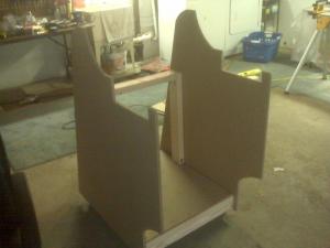

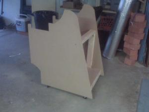

Unfortunately, the plans and measurements I started out with didn't hold up and I ended up sort of winging it as I went along. I did, however, keep a journal and tried to take lots of pictures during the construction phase. I would be happy to pass those along to anyone who wants them. Just PM me and I will get them to you.

Could I see pics or get info on that TV stand? I am looking for something similar but cant find any pedastal / pole stand under $400
The tv is actually mounted to the wall. The black tubular looking thing under it is just my plastic cable holder. Never really noticed that before but It does kinda look like it's holding up the tv in the pic. :)
Shoulda ran the cables down the wall and put a wallplate in. That's what I'm planning on doing. Put an HDMI port on the back of your pedestal too.

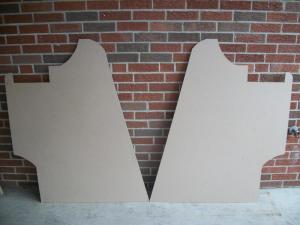

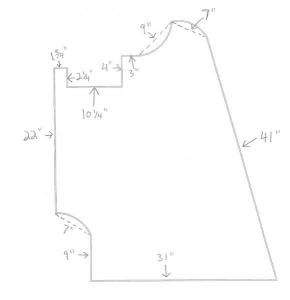

Love this!!! Would you like to share or sell any plans or pics? I was looking for a good design and absolutely would enjoy this. Anyways, I'f so, message me.
Thanks
Luis
You are the man!! This is much appreciated and thanks for taking the time to share with us. Absolutely beautiful!!!
Thanks
Luis

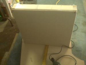

Baezl,

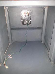

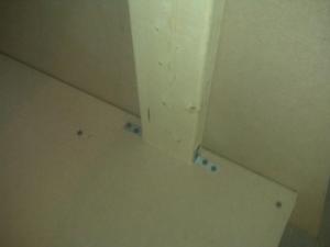

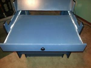

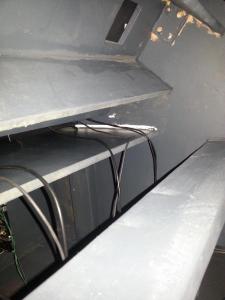

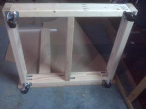

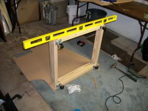

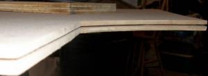

Hope these help. For the speaker board, I just used screws to attach it to the side panels. Behind the speaker board, I mounted a small board to hold the speakers, again screwing in through the side panels. I just made sure to countersink all of my screws and used wood putty and sanded it smooth before painting. I set my speakers directly behind the speaker grills and I use velcro to hold them in place. Nothing fancy at all. I did notice a lot of light bleeding through the speaker holes that I had cut so I just used some black felt to cover that up and that worked great. I left space behind the x-arcade for my hands to reach the rear buttons and switches and also attached the volume control directly onto the back of the x-arcade. This is not visible at all from the front while playing and gives me very easy access to everything.

Hi Quincy - I am interested in creating pedestal cab using a Tankstick similar to your build. Can you provide some more measurements, such as from base to topmost height above the speakers, width across the front, and the distance between the bottom of the Tankstick base and cabinet? Likely my build will differ in that I plan to build the sides out of birch plywood and will also have shelves inside to house several consoles in addition to a PC. Thanks in advance and bravo on a great build!
