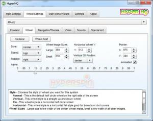

zahhhkinnn Posted September 15, 2014 Posted September 15, 2014 hi everyone this is my first post i have a question, how can i add space between the art images of my hyperspin wheels?? all are almost the same size but they are very close to each other and some even on top of one other. in other words, i have something like this: http://i.imgur.com/4QM04.png and i want it to look like this: http://www.nicolaslarosa.com.ar/frontend/6%20game4.png thanks for your help
gigapig Posted September 15, 2014 Posted September 15, 2014 Welcome to the forum ZahhhhhKinnn Have you messed with the sizes in HyperHQ?
kcorcoran Posted January 5, 2015 Posted January 5, 2015 I have this same question and sizes don't seem to help.. at least not in the horizontal wheel.. probably not so much in the circular wheel either. What we need is to have the h & v spacing variables bubbled up to HShq for configuration. Not sure how the spacing is being calculated now but seems to be a multiple of pixels from center of the artwork (blah) and not from edges of the wheel art's bounding box (which would be ideal). Are there any hidden/undocumented settings we could add to HS wheel ini files? like wheel_horz_space=100 and wheel_vert_space=100 ?? i could really use this setting for some custom theming. i'm a bit hobbled without it.
damageinc86 Posted January 5, 2015 Posted January 5, 2015 I just add extra canvas space around my wheel image,...or to the right of it, or left of it if I want to move it or add space.
DamnedRegistrations Posted January 5, 2015 Posted January 5, 2015 This is a feature many of us want, at least I always have. I believe it was supposed to be a tweakable parameter (modify margins between wheels) in HS 2.0 but yeah...
kcorcoran Posted January 6, 2015 Posted January 6, 2015 i spent the day trying to figure out and ask flash/fex programmer friends if you could do something like remote debugging on the HS exe to see if any calls to a spacing variable were being called and if adding those variables ot the ini would do anything. of course this is a bit of reverse engineering but without an answer from any of the HS dev team (aka BBB) I guess we just have to wait. blah. as for adding extra canvas space.. i'd hate to have to have people download all new wheel images if they actually like the theme after i release it. oh well.
