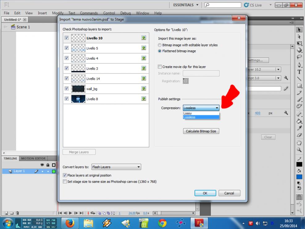

dark13 Posted September 25, 2014 Posted September 25, 2014 Are you importing a flv in flash to make an embedd swf video or are you importing layers in flash to animate it? In the first case you'll have some problems due to flv compression (higher flv bitrate helps), in the other case graphic should be almost "perfect". Check import options and select "loseless" for all layers/images used. For framerate chose 15fps,30fps,60fps or 120fps. In hyperspin it should not be that important as it seems to read .swf as fast as it can but syncronizing framerate with monitor refresh is always a neat idea Automatizing infopanels creation from .csv files for HTPCs themes (look at infopanel tutorial.zip on the ftp in dark13 folder) PNGs to SWFs automatized flash scripts Hyperspin Wheelset automatized template (photoshop's variables + batch) Aeon nox 4.13 W.I.P. hyperspin skin
