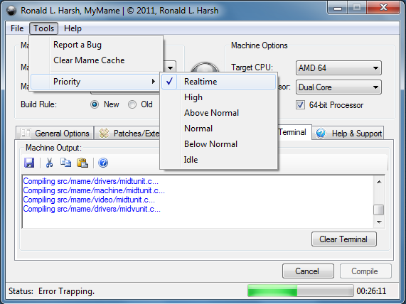

Rain Posted September 28, 2011 Author Posted September 28, 2011 Here is a little screenshot of MyMame 1.2 working it's Mojo and showing off the new priority control set that I added in: Are there any other tools that you would say an AIO Mame compiler should have? I have had a request to make a built in C++ editor but am not sure if that one will come to life as of yet or not. Any suggestions, ideals or concepts would be appreciated. Thanks guys!

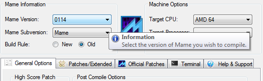

Rain Posted September 28, 2011 Author Posted September 28, 2011 Umm, not sure about the coffee - but portable settings can be done (oh, wait in fact here a picture is worth a thousand words.) Tooltips have already been put into the application as well. There is also an external help file with very good documentation. The save/load options allow users to save an array of different build guidelines and share them with other users, or just archive them for future use. It would probably be easier if I just added a what's new log to this post so that you will have an ideal of where the program is going: Added advanced error trapping. SHA-1 & CRC checks done on every file in/out. Added tooltips. Added Open/Save menue. Added complete help file. Automated error submission. Mame update notifier (notifies you when your Mame is out of date.) Exporting your recent built Mame game list. Enhanced memory control. Auto adjust processing power (based on CPU temp & RAM usage.) Added audio cues to notify of errors/completed build (optional) Fixed the open in explorer option. Added ZIP/TAR/Bzip compatibility. Added a system tray menu. Added an auto-hide feature (when compiling/optional.) Added a Windows 7 progress bar to taskbar icon (if running Windows 7.) Added the ability to submit error logs automatically. Added automatic loading of "last working" settings. Added slueth mode (which will build Mame only when PC is in an Idle state.) Added to option to pause the current process (in case you need to do something that requires more computing power, can resume as well.) Along with these added options I have a few more in mind to give a person total control, and offer a totaly easy to build Mame executable. So, outside of the above changes if there is anything else that you can think of or anybody else, just let me know and I will throw it in. In reference to your can the program be ran from any location query - the short answer is no. Right now MinGW is limited to a local disk as well as your Mame source code cache. If I attempt to move those then the variables in the program would all need to be rewritten - then there would be a huge chance of undesired errors within the application. The program does offer the option to load and save settings, but beyond that any configuration settings would only be for face value. That is not to say that someday I won't find a way around these limitations. Currently the program is now 20k+ lines of code and growing more everyday. I am about to move a lot of functions to external DLL files to save space within the internal applcation. But hey, I might be able to do what you are suggestion just because I love a good challenge! Thanks guys!
