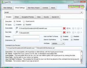

avisioncame Posted September 30, 2014 Author Posted September 30, 2014 Like Albert says, if you want to use fade and Hyperpause etc then you need to setup Hyperlaunch, you do that in Hyperlaunch HQ; have you done that?If you don't want those things and you want the game to start quickly then forget Hyperlaunch and just setup Hyperspin and the controls in Mame. This. I don't care much for fade, and would prefer the game to just pop right up. I turn off Hyperlaunch in HyperHQ, specify executable and rom paths, but when I select a game...nothing. Just doesn't do anything.
rfancella Posted September 30, 2014 Posted September 30, 2014 This. I don't care much for fade, and would prefer the game to just pop right up. I turn off Hyperlaunch in HyperHQ, specify executable and rom paths, but when I select a game...nothing. Just doesn't do anything. Be sure you have Use Full Path To Roms: Enabled Here is a setup that does work. Thanks, Ron Code Monkey and all around Command Line geek!If you like what someone has said or done for you, be sure and 'Thank' them. And if they changed your life, send them a Beer!
avisioncame Posted October 2, 2014 Author Posted October 2, 2014 Be sure you have Use Full Path To Roms: EnabledHere is a setup that does work. [ATTACH=CONFIG]45308[/ATTACH] Thanks, Ron That was it! Thank you!
