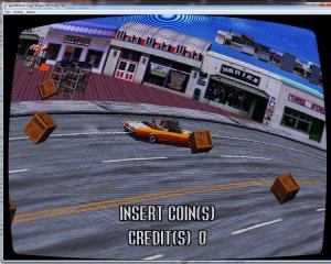

Styphelus Posted February 14, 2015 Posted February 14, 2015 Does anyone know if it's possible to change the scanline shader in Demul? There were some really old versions that used an opengl plugin where you could create your own shaders but not anymore. Scanlines look great at 640x480 but look terrible at 1920x1080. Problem in, in order to use a bezel, I need Demul set at 1920x1080. I haven't figured out a way to use a different resolution and have the bezel work full screen. Does anyone have a solution for this? I'm using Demul for Atomiswave and Naomi. I really wanted a bezel and scanlines but it doesn't seem possible.

Trnzaddict Posted February 15, 2015 Posted February 15, 2015 Does anyone know if it's possible to change the scanline shader in Demul? There were some really old versions that used an opengl plugin where you could create your own shaders but not anymore.Scanlines look great at 640x480 but look terrible at 1920x1080. Problem in, in order to use a bezel, I need Demul set at 1920x1080. I haven't figured out a way to use a different resolution and have the bezel work full screen. Does anyone have a solution for this? I'm using Demul for Atomiswave and Naomi. I really wanted a bezel and scanlines but it doesn't seem possible. Try to get sweetfx going and screw with the advanced CRT settings. I set up Sweet FX on Nulldc last night and looks great, but I had to use an older version....and that version doesn't want to work with the new Demul because it uses DX11. Nulldc must use DX9. I am......Machine
Styphelus Posted February 15, 2015 Author Posted February 15, 2015 Yeah, I got it working with NullDC and it looks great (using SweetFX-cgwg-CRT). Can't get it working with Demul however. Seems like the guys over at this thread were able to get it working but I can't reproduce the results. http://www.hyperspin-fe.com/forum/showthread.php?10276-Demul-scanlines/page3
gigapig Posted February 15, 2015 Posted February 15, 2015 I'm kind of getting somewhere with this but I'm still not overly happy with it. I'm just using the vanilla Sweetfx with Demul running at 1280x960 with 2x internal res.

Styphelus Posted February 15, 2015 Author Posted February 15, 2015 Yeah, I figured. Since Sweet FX doesn't work with DX11 and W8.1, I got creative and added scan lines to the bezel. I have to say, I'm quite impressed with the results. I had no idea it would work but it did.

Styphelus Posted February 17, 2015 Author Posted February 17, 2015 Ok, it's in your folder under atomiswave. There are 3 game bezels where the scanlines are 2 pixels apart and there's a test bezel with 1 pixel apart. See which one you like better. There's also a PSD file and the module. make sure you set demul to 1920x1080 and 4:3 resolution and FXAA as your only effect. It's not perfect but it's better than nothing. SweetFX does not work with Windows 8.1 and Direc X 11 unfortunately.
