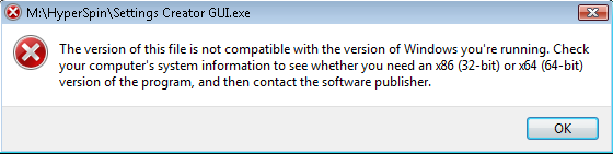

DrMoney Posted October 31, 2012 Posted October 31, 2012 I also notice that the original exe that comes in the archive gives an error about an incompatible version of Windows, would me being on Vista 32 bit be an issue? TUTORIAL!: Xpadder and You If you're super into using genuine controllers for emulation check THIS GUY out.
wahoobrian Posted October 31, 2012 Posted October 31, 2012 DrMoney - I had that same error initially. It was because I was not running AutoHotkey_L, one I installed that version, I was good to go. Hope this helps.
dustind900 Posted October 31, 2012 Author Posted October 31, 2012 Yes AutoHotkey_L is required. I just assumed everyone had L installed as it's required by HyperSpin.
brolly Posted October 31, 2012 Posted October 31, 2012 HyperLaunch uses the dll that's on the HS folder to launch the modules so you don't really need to have Autohotkey_L installed, I'm guessing most people will have the basic version.
dustind900 Posted October 31, 2012 Author Posted October 31, 2012 Thanks Brolly. I'll update the first post so people will be aware that AutoHotkey_L is required. It shouldn't be a problem though if people use the compiled exe... Am I right? I also notice that the original exe that comes in the archive gives an error about an incompatible version of Windows, would me being on Vista 32 bit be an issue?[ATTACH=CONFIG]21240[/ATTACH] I'm using Win7 x64. Does this matter? Could someone chime in here?
