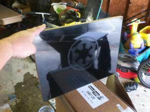

trailervert Posted May 28, 2013 Posted May 28, 2013 I did this with a can of Rust-olium Enamel. Its 3 coats primer, 3 coats enamel, 3 coats clear with a crap ton of sanding in between. Wet sanded the clear at 2000 grit then finished with Turtle Wax rubbing compound.

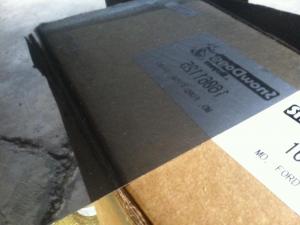

trailervert Posted May 28, 2013 Posted May 28, 2013 Here is an up close view. Its not automotive finish nice, but it only cost about $20 and an hour of sanding.
Fursphere Posted May 31, 2013 Posted May 31, 2013 Are those pics MDF or Plywood underneath? Either way nice work!
