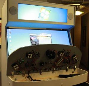

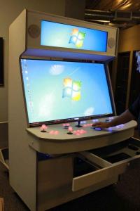

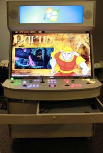

esmith13 Posted October 22, 2012 Posted October 22, 2012 Apparently it's been done with a commercial grade marquee LCD too. See here: Completed my 1st Arcade Cabinet Aug. 2012 after 2yrs planning and saving... - GONE 2 days later to a friend!! ... Bartop build: 85% complete (need to install CP and get/install cabinet art)
esmith13 Posted October 22, 2012 Posted October 22, 2012 Some stills of the one already done... (posted a youtube video link of this in action as well but that post is awating moderation) Eric Completed my 1st Arcade Cabinet Aug. 2012 after 2yrs planning and saving... - GONE 2 days later to a friend!! ... Bartop build: 85% complete (need to install CP and get/install cabinet art)
BladeZX Posted October 22, 2012 Author Posted October 22, 2012 Looks nice. That is a wide cabinet. Is that the LG M2900S lcd? If so is it decased - how big is it decased? HyperPin Manager | HyperSpin Manager | HyperSpin Checker | HyperSpin Renamer ASRock Z77 Extreme4 MB | Core i5 3570K | Coolermaster Hyper212 EVO CPU cooler | 16GB RAM | OCZ Vertex 4 128Gb SSD (Windows 8) | OCZ Vertex 4 256Gb SSD (HS and all emulators and media) | Gigabyte GTX670 2Gb video card | 27" ASUS LED monitor | 650W Corsair PSU
esmith13 Posted October 22, 2012 Posted October 22, 2012 All they say in the video is that it's a 55" samsung smart tv... Completed my 1st Arcade Cabinet Aug. 2012 after 2yrs planning and saving... - GONE 2 days later to a friend!! ... Bartop build: 85% complete (need to install CP and get/install cabinet art)
