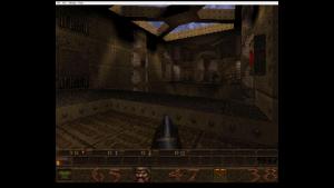

manson976 Posted May 24, 2016 Posted May 24, 2016 You DON'T need any special scripts or either modified ones just make hard drives with a collection of games... EASY Set your directory in RLauncher to those HDF files and name your EMU Folder to Acorn Archimedes not ARCULATOR. Make a folder inside the profiles folder for controls remember system name must be attached and inside that a folder matching the rom name. Check it out: http://www.hyperspin-fe.com/topic/15187-arculator-acorn-archimedes-woes/page-4 Resolution is a pain but as long as you have the correct !boot installed as I said 3.7 OS NOT Uniboot that seems to be floating around Extract that into your HOSTFS ie.. !BOOT in the root directory Arculator ARM 33mhz - but that has to change for speed on some games ie AGRESSOR 8mb RAM RISC OS 3 NEW RPC Strong ARM 32mb RAM Make sure you have V-Ram set to 2 for resolution to work Key f12, then type as follows *cofigure filesystem hostfs *configure boot Then key the RETURN key to bring you back to the pinboard RESET EMU Click !Boot in the hostFS directory then Click SCREEN Set it to Acorn AKF-50 800x600 32 Thousand Reset again Congratulations You can Now Kill The Evil Hoard In QUAKE!
