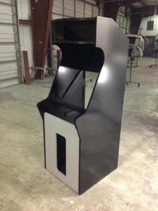

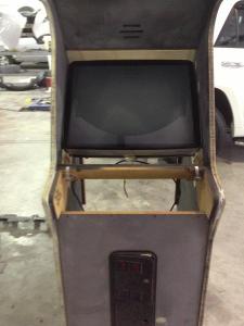

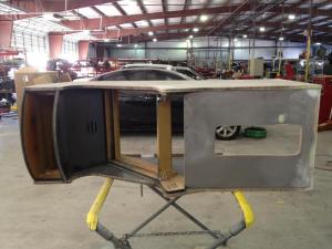

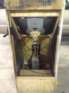

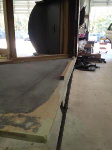

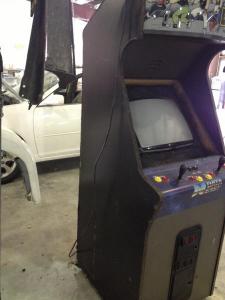

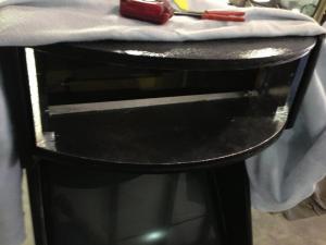

Shanenashley Posted November 15, 2012 Posted November 15, 2012 Hey Everyone, I'm finally starting on my first Mame cab. and thought I would show a couple of Pic of my work (wood restoration, lol). I knocked out bottom and back to put new pieces. Planning on a recessed floor and adding casters. Just starting and hopefully I can get most of it done before January 18, 2013.Got a baby girl coming. If not no biggie just will take my time.

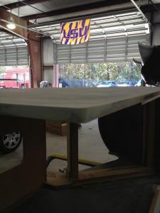

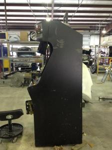

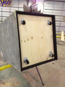

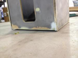

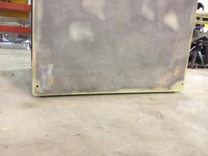

Shanenashley Posted November 17, 2012 Author Posted November 17, 2012 Got the back and floor done. I'm liking the low rider look with flush mounted wheels!
dazsnee Posted November 17, 2012 Posted November 17, 2012 Wow looking good mate, should make a nice project! Interesting cabinet too with the curved marquee.

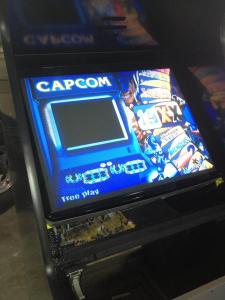

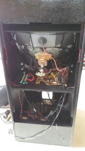

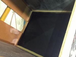

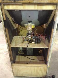

Shanenashley Posted December 7, 2012 Author Posted December 7, 2012 Finally after Careful measuring and planing I squeezed a 27" in this cab. Can barely fit a piece of paper on the sides. I did build two shelves two for computer down below and tv board.
ericleroi Posted December 9, 2012 Posted December 9, 2012 Coming along nicely - good job on getting the base sorted out and squeezing that bohemoth of a display in there! I reckon a nice speaker grill up top would add to the aesthetics.

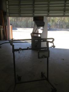

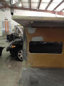

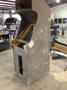

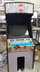

Shanenashley Posted February 1, 2013 Author Posted February 1, 2013 After 3 coats of primer and a full block session in between, finally got her painted. Went with a semi-gloss finish. I tested a full clear coat and didn't really feel an old school touch to it. next going into the booth is the striped down and metal reworked coin door, And I didn't make it in time, lol.
rdhanded2 Posted February 1, 2013 Posted February 1, 2013 Very clean looking. Awesome work My Tekken 3 pedestal conversionBasement Bar / Arcade

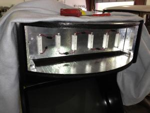

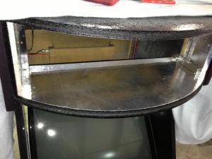

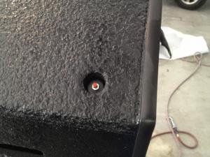

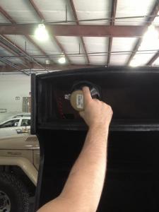

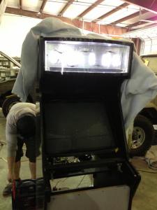

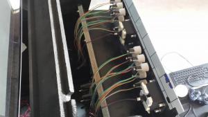

Shanenashley Posted February 23, 2013 Author Posted February 23, 2013 Here's a few pics of what I did new. Power switch,Speaker, and Got the Marquee lighting done. The Foil Tape was so awesome to use. And I just did a small test run to make sure the tv worked. Didn't leave it on long though because I am going to have to raise the speaker inside the cab some. The magnet is to strong and distorting the tv a little just on the top. I'm glad I checked. And please no arm jokes.

Shanenashley Posted March 9, 2013 Author Posted March 9, 2013 Here's my cpo and Marquee. The Black and white circles are just for button cutout. they wont be in final artwork. Trying to keep it simple and cartoony,Brick is the same. Just looks like a different shade when zoomed all the way out. Uploaded with ImageShack.us[/img]
zomboided Posted March 12, 2013 Posted March 12, 2013 I know this isn't helpful, but the pacman looks like he's holding a nob.... However, the foil tape is a fantastic idea! I was wondering how to get the light box working effectively on my cab with LED lights. [sIGPIC][/sIGPIC]
THK Posted March 12, 2013 Posted March 12, 2013 Nah man, he's taking his boner pill for Ms. Pacman ..........................back with a vengeance........................

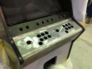

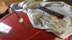

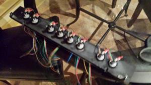

Shanenashley Posted April 24, 2013 Author Posted April 24, 2013 Finished Welding up the original panel and drilling out my new holes.

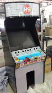

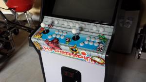

Shanenashley Posted May 7, 2013 Author Posted May 7, 2013 Graphics applied and now to save up some money for all the rgb buttons and joysticks. lol Thanks goes to RidicRick for printing out my graphics. He even did my Marquee twice cause I sent him the wrong file. They look great.
MontyQ Posted May 7, 2013 Posted May 7, 2013 looks sweet I like it nice job, you also doing side art ?
Shanenashley Posted May 13, 2013 Author Posted May 13, 2013 Thanks for the kind words. I didn't plan on doing any, was just going to keep it simple. The sides were sprayed with a semi-gloss automotive paint and are real smooth with no specs of trash. Why cover up a good paint job, lol.

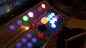

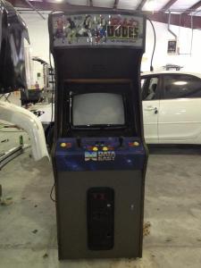

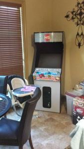

Shanenashley Posted October 7, 2013 Author Posted October 7, 2013 I'm Done! Here's some final pics. Can someone add me to the members projects please
