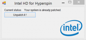

BenjaminLSR Posted September 14, 2014 Posted September 14, 2014 Download it: https://www.mediafire.com/?7h0l5abcbwqb2zc I made a little software to fix the issue with Intel HD/GMA with Hyperspin and MP4 videos. Enjoy. Just to let you know: - It changes the 115th bytes on flash.sys file from 1 to 0 (and reverse).

Firepowers Posted November 17, 2014 Posted November 17, 2014 I am just about to go back to XP. I have tried lots of things about my win 8.1 from the Windows sites about running MP4 to no avail. I have tried the Flash one above but there are nothing in Settings to un-check hardware acceleration. I used the built in Flash player to Win 8.1 but maybe I need to download it. I have tried the patch above by BenjaminLSR and it says it is already un-patched the first time I clicked on it. Is there any other ideas to get MP4s running on Win 8.1 X64 ENG INTL? Thanks

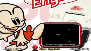

DrMaxwell Posted November 17, 2014 Posted November 17, 2014 I have a Sony Vaio with Intel HD4400 and had this garbled video problem. I fixed it though; it took me about an hour to figure out how by myself. I have a hacked version of xp in my arcade cab and was sick of trying to transfer stuff back and forth between my cab and my Sony Vaio that came with windows 8.1 on it, so I grabbed a 2TB HDD for the databases and artwork to operate out of my Sony Vaio, use Photoshop and mint my unsupported sets faster. Here is a shot of PC Engine main menu in windows 8.1 using the snipping tool to grab it: How to guides and custom artwork sets @ https://www.youtube.com/user/MaxwellParadigm Themes, Wheels, Carts and Database Downloads available @ http://spacevalkyrie.weebly.com/
