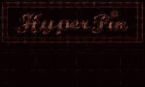

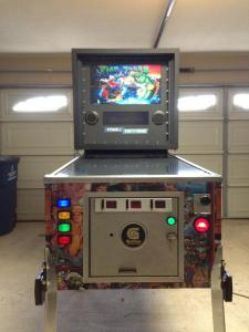

citizninsane Posted May 15, 2013 Posted May 15, 2013 I created a custom background in Photoshop for the DMD screen. The background is the same aspect ratio of my third monitor and I only filled the top portion of it with a DMD style version of the hyperpin logo. Here's a jpg of the background and a shot of the end result: Hope that helps!

citizninsane Posted May 15, 2013 Posted May 15, 2013 How it works,,,???that this LOGO is working only on Pins without a DMD Yea, it's just there as a filler when you're in the Hyperpin table selection UI and when the table DMD is being represented inside if the directb2s file. For example, the Black Hole DMD screen is actually in the directb2s backglass so the screen designated for the DMD isn't in use. Instead of it being a solid black desktop background or some other picture, I just use this instead. The DMD's on the games that aren't part of the backglass just go over it...just like they would on any other desktop background, make sense? It's not interactive at all, just a quick and dirty hack to fill the DMD screen when it's not in use by Hyperpin.
