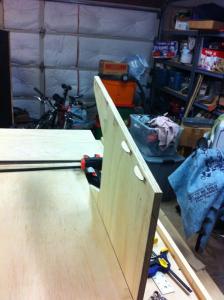

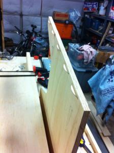

Fursphere Posted January 26, 2013 Posted January 26, 2013 Hey there Started a new cabinet last weekend. I was so inspired by gbeef's Outrun project, that I decided to build my own. I didn't have any plans to go off of, and very little information about what the dimensions of the thing are, so I traced out a picture of gbeef's, then used so mathematics to get a rough idea of the rest. Here is how far I got last weekend... Hoping to finish up the base construction today, and start working on the top section. I just picked up a 32" LCD screen last night since Best Buy had one I liked on sale. More to follow... **Running Total of Costs - 6/15/2013** 2.5x 4x8 Sheets of 3/4" cabinet grade plywood - $90 (Home Depot, have a half sheet left over.... bartop maybe?) 4x 2.5" casters - $30 (Home Depot) 32" LG 1080p 60hz LCD - $330 (Best Buy) Seat - $130 (ebay) Logitech G27 - $200 (amazon on sale) Daytona arcade dash - $50 shipped (ebay) Misc nuts and bolts - $15 (lowes, home depot) Couple of tools for better finding angles - $10 5.1 Logitech Speakers - Donated from a friend Sound Ordnance 2x100waat amp $80 Bondo Filler - $10 (lowes) Aura Bass Shaker - $50 -------------------- ~$1000 so far Added v1 of the plans for the cabinet. Bunch of PNG files and a Google Sketchup 8 drawing. mycab.zip

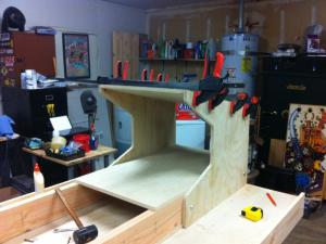

Fursphere Posted January 26, 2013 Author Posted January 26, 2013 Just got done bolting the sides to the base and gluing the "top" on. Man I love my biscuit jointer!
nitussi Posted January 27, 2013 Posted January 27, 2013 Looking good and can't wait to see it finished so I can tackle a sit down myself. Yeah I always say that biscuits are better than screws and dowels, and a jointer is a must for this type of stuff. Most of my edge joining I use one of my router tables with the right bit, its a lot faster. For non edge joining, I use the biscuit Joiner. Vertical Cab Mini Vertical Bartop Dual Impact W.I.P. Mini MvC cab Versus Bartop WIP

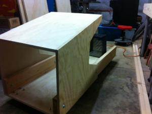

Fursphere Posted January 29, 2013 Author Posted January 29, 2013 Not a lot of progress, but I did manage to get the casters installed so it'll be easier to move around. I'm still working on getting the upper sides drawn out. Getting close to being able to cut them out.
