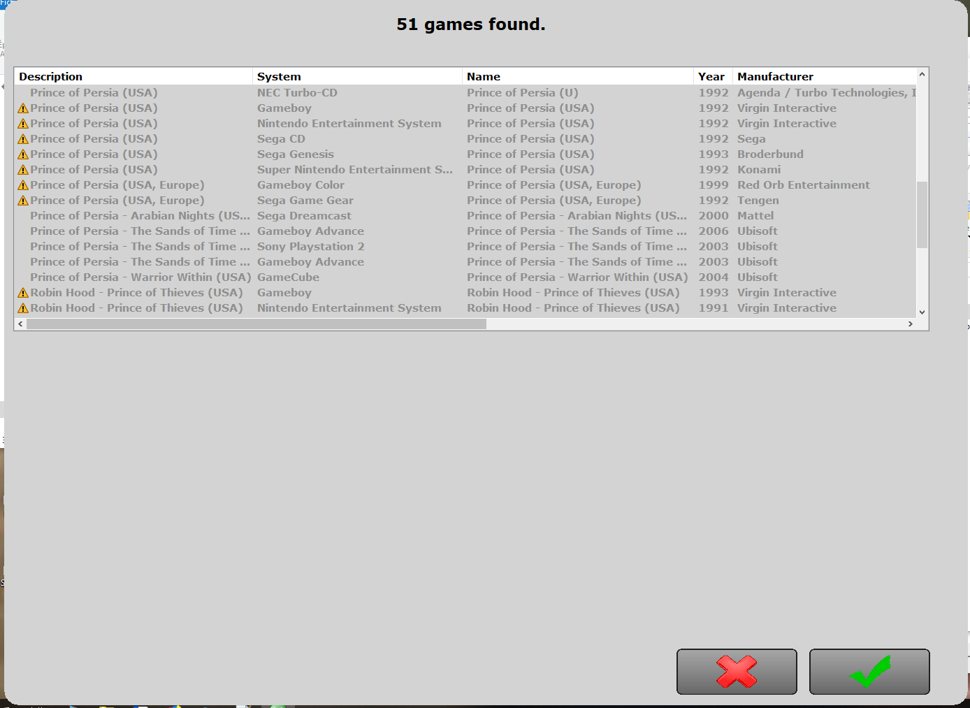

r0man0 Posted May 23, 2019 Author Posted May 23, 2019 Hi , i've updated Hyperxmlspin to 1.8.0.6beta5 , with those changes : Version 1.8.0.6beta5 +05/22/2019 - Fixed --> Function "Add" was not filter games from selected list. +05/21/2019 - Added --> Icon "Warning" for games that have same game name.(see attachment) Lists created with games that have same game name are modified using a space before game name ( ) to become visible through hyperspin wheel, but they are unsupported with LedBlinky. +28/03/2019 - Fixed --> Some systems with the same beginning name as another were not detected.

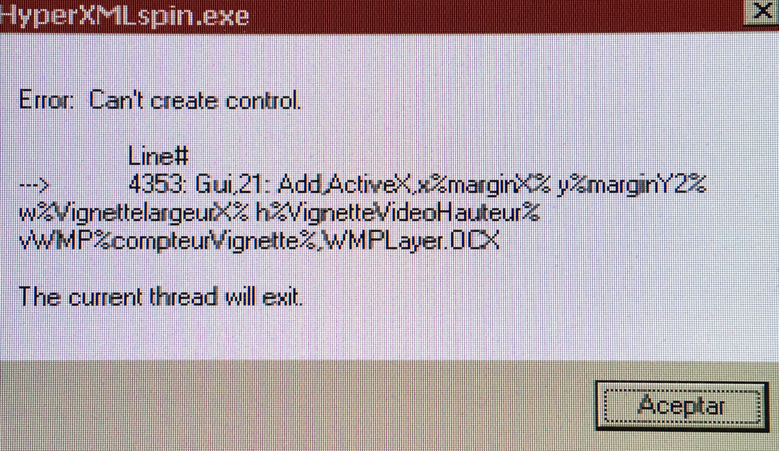

drazil Posted June 29, 2019 Posted June 29, 2019 I managed to install and configure it, but I think there may be some problems with my installation, as HyperXMLspin is throwing errors ramdomly. I managed to complete some searches but, most of the time, when I launch a search (eg. simple search by name), after the search is complete, I get an error window: "Cant create control". Please see attached snapshot. I hope someone can help me, as this is great addition for Hyperspin and would like to have it working properly. r0man0 congrats for this great add-on!! Many thanks!!!

r0man0 Posted June 30, 2019 Author Posted June 30, 2019 Hi this error happens when Windows media player activeX IS not find , you Can try to install a codec pack that include wmp : https://www.codecguide.com/download_k-lite_codec_pack_standard.htm be carefull to install this pack : don't click next all the Time to install it , you have to decline some offers at the end of installation. Hope that could solve your issue. R0MAN0
drazil Posted June 30, 2019 Posted June 30, 2019 6 hours ago, r0man0 said: Hi this error happens when Windows media player activeX IS not find , you Can try to install a codec pack that include wmp : https://www.codecguide.com/download_k-lite_codec_pack_standard.htm be carefull to install this pack : don't click next all the Time to install it , you have to decline some offers at the end of installation. Hope that could solve your issue. R0MAN0 Thanks for the reply! I'll test this evening and will let you know the results. Much appreciated
drazil Posted June 30, 2019 Posted June 30, 2019 I installed the codec pack with no success. After that, I manually registered wmp.dll (using regsvr32). I thought I had solved the issue, but it worked just a couple of times, so I'm back to the starting point The thing is that it appears to crash ramdomly (eg. I perform a search - works properly, then go back, perform the same search and get the error...). Thanks for your help!

r0man0 Posted July 2, 2019 Author Posted July 2, 2019 Have you tried this tip to register manually WMPLayer.ocx : http://www.ctimls.com/Support/KB/How To/Register_dll.htm
KRIS85 Posted July 3, 2019 Posted July 3, 2019 8 hours ago, r0man0 said: Have you tried this tip to register manually WMPLayer.ocx : http://www.ctimls.com/Support/KB/How To/Register_dll.htm you can not load the wmp.ocx module, you can not find a specific module :\ Edit: Ok, I managed to register, but it did not help, I reset my pc, etc. but continue the same error WTF Sometimes it fires, but this error pops up, I do not know what is StackHash_0a9e
r0man0 Posted July 3, 2019 Author Posted July 3, 2019 Hi , if wmp plugin doesn't works , try to install vlc with activex : here is a new beta that include vlc plugin , you can select the video preview on parameters options . after some tests this version (vlc) is instable there is bugg when click on videos , but that could solved your problem temporaly till a next new release. Otherwise you can select "none" into video preview. r0man0
KRIS85 Posted July 3, 2019 Posted July 3, 2019 16 minutes ago, r0man0 said: Hi , if wmp plugin doesn't works , try to install vlc with activex : here is a new beta that include vlc plugin , you can select the video preview on parameters options . after some tests this version (vlc) is instable there is bugg when click on videos , but that could solved your problem temporaly till a next new release. Otherwise you can select "none" into video preview. r0man0 HyperXMLspin_v1_8_0_6(2019-07-03).exe 12.13 MB · 0 downloads Ok but if i click this file is The page you requested does not exist rrrrr i think problem is im not premium user o download this version in topic we'll see if it works Edit: Unfortunately, the same error
