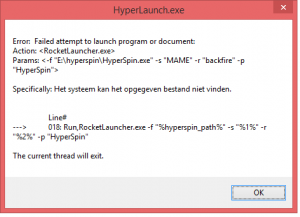

Hi all,
Because i've installed hyperspin and rocketlauncher over my old installation, i have this error now i cannot fix :(
Does anyone where i can set the right settings for this error. It seems that some paths are set wrong but i've checked everything in rocketlauncher and as far as i can see, the setting are right. Would appreciate it very much if someone can give me a push in the right direction
Error says, system cannot find the specified file (see attached image)
thanks

You need to post some logs etc. The HyperSpin Log, the RocketLauncher log if you have tried to run it and the HyperSpin settings.ini found in HyperSpin\settings folder

Sorry could you also post the Mame.ini which can also be found in the settings folder.
From the RL log it shows that Mame is not starting.
Hey all,
For sure the error is a common one.  Usually it means the emulator is not launching.  Part of RL is to detect that the emulator has launched before it moves on.  If the emulator is not launched, the script will error out.
For future, please use code tags when posting logs.  Posting logs without code tags will mess up the log and make the thread very difficult to read.
So, first things first.
Can you launch MAME outside HyperSpin and RocketLauncherUI?  And select the game and does it run??
If you can, that's half the battle.  ;)
The next step is to see if RL (RocketLauncher) is sending the correct CLI to launch the game.
In Windows 8 (I don't know of an eaiser way) while you are looking at your tiles screen, move your cursor to the top right until the "Charms Bar" slide out.  In the box under Apps, type run.  Click the Run icon to get a Run box.  Type cmd in the box and hit enter.
Paste this into the DOS box:
E:\emulators\MAME\mame.exe oedfight -nowindow -nohlsl_enable -video d3d -artwork_crop -nouse_bezels -use_overlays -use_backdrops -nouse_cpanels -nouse_marquees -rompath "E:\emulators\MAME\roms"
Hit enter.
Does MAME launch with the game?  Or do you get an error??
Thanks,
Ron
  On 6/18/2015 at 9:25 PM, rfancella said:
Hey all,
FYI Ron, code tags still don't work on this site (see edit to post above)
Arrrgggg...
At least code tags don't screw up the txt??
Thanks,
Ron
  On 6/18/2015 at 7:01 PM, hyperdennis said:
i have hyperspin 1.3.3 and rocketlauncher installed.
In the rocketui, mame appears as a system among all the others.
I've tried to run the transition tool three times and it did not work.
After closing hyperspin, i did see some error message about that i should try mame outside hyperspin or turning of/on fade or something. It went away quick and i only saw it once,
This is the transition tool error log, the last one. When i tried for the third time..
01:28:57 |  Starting transition
01:28:57 |  Could not find your Media folder from the this folder to rename, perhaps it was renamed already? ERROR\Menu Images\HyperLaunch
01:28:57 |  Could not find this folder to rename, perhaps it was renamed already? E:\hyperspin\ERROR\Menu Images\HyperLaunch
01:28:57 |  Could not find this folder to rename, perhaps it was renamed already? E:\hyperspin\ERROR\Menu Images\HyperPause
01:28:57 |  Could not find this file to rename, perhaps it was renamed already? E:\hyperspin\ERROR\Menu\hpbmenu.wav
01:28:57 |  Could not find this file to rename, perhaps it was renamed already? E:\hyperspin\ERROR\Menu\hpsubmenu.wav
01:30:43 |  Skipped renaming HyperLaunchHQ folder and its files
01:30:43 |  Searching for ini files to transition...
01:30:43 |  File | E:\hyperspin\HyperLaunch.ini TO E:\hyperspin\RocketLauncher.ini
this is why I asked you to skip to step 3-B
you are doing a full transition,  trying to rename your Hyperlaunch to rocketlauncher.   You don't have  a Hyperlaunch3 folder to rename to Rocketlauncher.
You need to transition Hyperspin ONLY!!
can you post your MAME.ini
found at
Hyperspin/Settings/MAME.ini
top of your MAME.ini
[exe info]
path=  if this path is not set to Rocketlaunche.exe  mame will not work.
rompath=
userompath=false
exe=MAME.exe
romextension=zip
parameters          =  if this is blank your mame will not work
searchsubfolders    = false
pcgame=false
winstate            = HIDDEN
hyperlaunch=true
Found the trouble. The rompath and romextension were not defined in the mame.ini.....
Mame is working again in hyperspin #yaaaay!
but i still do not get a new window when i double click on a system in rocketlauncherUI.
Only option i have is to use the button (edit database for your selected system in editor) What editor is best for this?
And how can  i fix that issue with the system window? Because now i want to add some pc games and more emulators
All new systems are added via HyperHQ as normal correct? And RLUI should pick them up, but you may need to run the transition tool again after adding new systems so that the ini's are changed.
if that is not the case please someone correct me.
