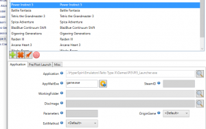

Metalzoic Posted November 28, 2015 Posted November 28, 2015 Have you tried Launching the games first through Arcade PC launcher to set your settings. Then, in the module settings, Setting "Title_Launcher.exe" as your Application ID and the AppWaitExe as "Game.exe"? (For example for Trouble Witches it would be TW_Launcher.exe as the application and Game.exe as the AppWaitExe) That's how I have almost every one of mine setup and they all work. I just set them all up last Sunday.

Deezdrama Posted November 28, 2015 Author Posted November 28, 2015 I installed ArcadePC Loader into my folder that already had the Games folder in it. If your folder structure isn't already like that then I guess you'd need to move em. However that will mean you need to re-set them all up. -Instead of using FadeTitle just put "game.exe" in the AppWaitExe instead like I said. Both do similar things. FadeTitle is required for most normal PC/Steam games though. -You do not need to edit the game.exe at all for Samurai Shodown. I posted about this in Austins thread Taito type X thread. You don't need to go through all that he mentioned. All you need to do is use AutoHotKey in the RocketlauncherUI keymapper settings to change them really quick. Super simple if you know how AutoHotKey works. My last 3 posts in this topic: http://www.hyperspin-fe.com/topic/10448-ttx-games-or-pc-arcade-games/page-5 I can help you if you need. I already changed controls in the exe last night on sam showdown so am good to go unless arcadepcloader will change it back to default. I copied all the games to arcadepcloaders folder structure and set everything how I wanted. Now...... Do I just run the games with the same bats and exes that I did before setting with Arcadepcloader? thanks again man!
Metalzoic Posted November 28, 2015 Posted November 28, 2015 I copied all the games to arcadepcloaders folder structure and set everything how I wanted. So you're saying you changed the settings, controls etc... and launched the game in ArcadePC Loader? Now...... Do I just run the games with the same bats and exes that I did before setting with Arcadepcloader? No. You would run them by making the GameTitle_Loader.exe your Application to launch in the module and game.exe your AppWaitExe in the module like I mentioned earlier.If a game doesn't work that way then try a .bat file (half Life needs it for example) EDIT..... weird..... I just tried launching ssf4ae after setting res to 1080 in arcadepcloader, it minimizes to the task bar and I can hear the game but maximizing it wont work. This is outside of RL.Most of the games originally did this and only way I could get them to work was to run the typex_config and set lowres to yes. Some games will only work when set to a specific res. So for that game just start trying all of them. In the arcade it was probably 1366x768. You just need to experiment there. Edit 2.... I just ran SSFIVAE_Launcher instead of launcher.bat and it looked much better in 1080 but was windowed even though I have fullscreen selected. Also...it must need me to reset controls as my mappings are gone. Yes... I've been telling you to use the gameTitle_Launcher instead this whole time. You also need AppWaitExe to be game.exe. You should have done controller mappings in the ArcadPC_Loader settings before you launched it. Tried chaos breaker as it had really low res.....still has really low res and the game played in super fast motion and was fullscreen but the actual ingame video area was a small square. Chaos Breaker (and several others) will only work right when set to certain resolutions. You need to experiment. Also make sure you have bezels turned off Maybee this is one of those situations where I should just run them like I had them and leave good enough alone? Maybe. It seems like you are getting things mixed up. -Set all game settings in ArcadePC_Loader. Settings, res, controls, language. Everything you can.-Run the game to test it until it works good-Set the GameTitle_Loader.exe as your Application.exe in the RocketLauncher module settings (for example SSFIVAE_Launcher.exe)-Set game.exe as your AppWaitExe in the RocketLauncher module settings. Test again to see if it all works good

Metalzoic Posted November 29, 2015 Posted November 29, 2015 That error is caused because there is no correct AppWaitExe (such as game.exe) in the settings, so RocketLauncher has no way of knowing to stop waiting for the game to load. If it doesn't have a game.exe then look for another exe that could possibly be the actual game program and stick it in there. Or instead of setting AppWaitExe (leave it blank) try setting a FadeTitle instead. Click on the box next to the setting and it will tell you how it works. I found it to be iffy with the Taito X games though. Not sure why SShodown won't run from the loader for you. A quick double click and it launches fine with my settings for me. Although it is also a game that won't launch unless you have the right resolution picked. Have you tried multiple resolutions with it? Did you set the controls first (they won't work id you skip that step). Did you set it to English? And my mistake, sounds like I should have been telling you XXXX_Launcher.exe this whole time. No wonder you didn't know what I meant. I gave bad instructions. Ha!
Deezdrama Posted November 29, 2015 Author Posted November 29, 2015 The main exe for ssf4ae is Ttxshell.exe, Ive had that set, tried it blank, and messed with fadein for hours. I can set fade delay and it will get to the game but just minimizes once the delay time runs out. For sshowdown, yes.... Ive set inputs and tried running at all resolutions...It just wont run with arcadepclauncher.... runs fine on its own but low res arggggg.... my third day trying to button up ttx.... and still have some wheel issues to address. I think Im going to try to find different files.
gigapig Posted November 29, 2015 Posted November 29, 2015 Run SSFIVAE 2012. Go into task manager and look for the process that is running, that will be your appwait. I'm pretty sure it's not ttxshell. Metalzoic has explained how to get the fadetitle ( sometimes you don't need it and it can be blank but I think that's been mentioned ) or it's in my videos.
gigapig Posted November 29, 2015 Posted November 29, 2015 Fade for the version of SSF I sent you is "SF41 - Nov 4 2010 14:01:12 ahk_class SF41" and is what I have set. Appwait would be SF41.exe
Deezdrama Posted November 29, 2015 Author Posted November 29, 2015 woooot! I got it working. I forgot the old fadetitle was being used from the first game version I been having problems with. I just had to delete the rom settings and create a new one, left appwait blank and its running fine now. Thanks everyone! Only need to figure out how to get Sshowdowns res set now
