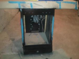

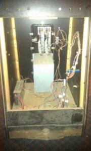

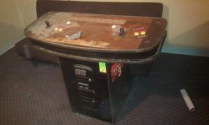

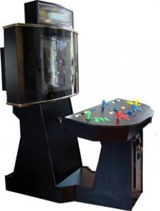

rdhanded2 Posted January 9, 2012 Posted January 9, 2012 I am pretty far along on my project so I thought I would share some pics, and say thanks to everyone here. You have all helped me out TREMENDOUSLY. I wanted a pedestal so I could use my TV, and also move it around when not in use. I found an old Tekken 3 cab that was the style of the pic below someone was throwing away, and was in bad shape. I removed the front monitor part and got to work on it My Tekken 3 pedestal conversionBasement Bar / Arcade

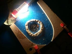

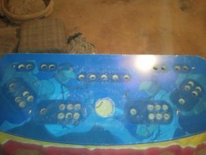

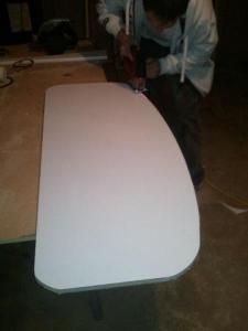

rdhanded2 Posted January 9, 2012 Author Posted January 9, 2012 Started cleaning it up, removing the guts, and making a new top My Tekken 3 pedestal conversionBasement Bar / Arcade

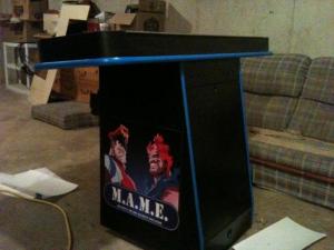

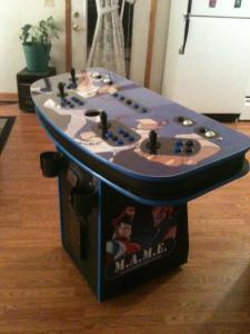

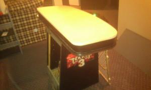

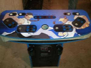

rdhanded2 Posted January 9, 2012 Author Posted January 9, 2012 For graphics I just used pics from the FTP and tweaked them somewhat for my cab. My Tekken 3 pedestal conversionBasement Bar / Arcade

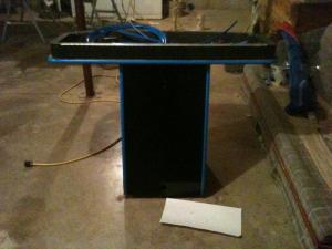

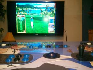

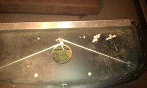

rdhanded2 Posted January 9, 2012 Author Posted January 9, 2012 And now, testing out the most important upgrade i made!! My Tekken 3 pedestal conversionBasement Bar / Arcade

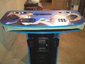

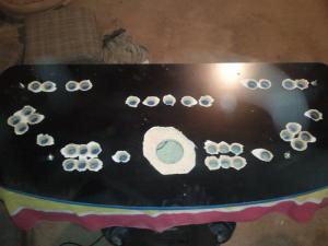

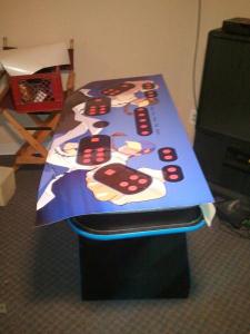

rdhanded2 Posted January 9, 2012 Author Posted January 9, 2012 I have to finish the acrylic and then wire her up. PC is done and ready to install. Hopefully I will be done by next weekend. My Tekken 3 pedestal conversionBasement Bar / Arcade

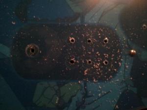

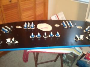

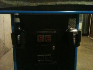

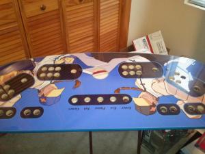

rdhanded2 Posted January 13, 2012 Author Posted January 13, 2012 Couple update pics. Cutting plexiglass and painting the back. Not much progress this week because of work, but hope to finish it this weekend. My Tekken 3 pedestal conversionBasement Bar / Arcade
rdhanded2 Posted January 17, 2012 Author Posted January 17, 2012 Finished up the back, and got the side graphics on. My Tekken 3 pedestal conversionBasement Bar / Arcade
rdhanded2 Posted January 17, 2012 Author Posted January 17, 2012 Big thanks to analogkid666 for giving me the idea to use a router and flush trim bit to cut out the holes in the plexi. Made it super simple and fast. Used the router to sink in the u-trak so it is flush with the plexi as well. My Tekken 3 pedestal conversionBasement Bar / Arcade
rdhanded2 Posted January 17, 2012 Author Posted January 17, 2012 Acrylic is finished and installed. Starting to come together. My Tekken 3 pedestal conversionBasement Bar / Arcade

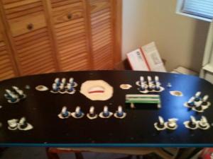

rdhanded2 Posted January 17, 2012 Author Posted January 17, 2012 Buttons going in, and I-Pac on the board. My Tekken 3 pedestal conversionBasement Bar / Arcade
rdhanded2 Posted January 23, 2012 Author Posted January 23, 2012 Track ball is not in but otherwise it is ready to go! I am happy with the turn out, and it works! lol Always awesome feeling when you fire up something for the first time and it works. My Tekken 3 pedestal conversionBasement Bar / Arcade
rdhanded2 Posted January 23, 2012 Author Posted January 23, 2012 Donkey Kong had to be the first game played!! My Tekken 3 pedestal conversionBasement Bar / Arcade
xagesz Posted January 24, 2012 Posted January 24, 2012 Awesome. Love it. TV seems low though. Oh well GAME ON. Save that princess. "Pinball Unknown" - 46/30/DMD - A work in Progress Kick it Harder
rdhanded2 Posted January 24, 2012 Author Posted January 24, 2012 Not the TV it is going to be used on. Basement bar is not done so testing it in the living room. My Tekken 3 pedestal conversionBasement Bar / Arcade

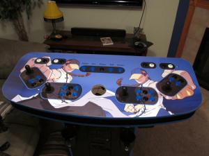

rdhanded2 Posted January 25, 2012 Author Posted January 25, 2012 Thanks guys!! I found the control panel art on the FTP actually, and tweaked it for my setup. My Tekken 3 pedestal conversionBasement Bar / Arcade
rdhanded2 Posted February 16, 2012 Author Posted February 16, 2012 Finished it up finally. Now just need to finish the game room and get it out of the living room!! My Tekken 3 pedestal conversionBasement Bar / Arcade

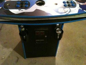

gstav Posted February 23, 2012 Posted February 23, 2012 Sweet build! Where did you get the cup holders? Arcade + beer = "Stop being so stupid.. it’s my turn."
rdhanded2 Posted February 23, 2012 Author Posted February 23, 2012 Sweet build! Where did you get the cup holders?Arcade + beer = ebay actually. http://www.ebay.com/itm/MULTI-SIZED-CAN-AND-CUP-HOLDER-/120406119039?pt=LH_DefaultDomain_0&hash=item1c08c3927f My Tekken 3 pedestal conversionBasement Bar / Arcade
gstav Posted February 23, 2012 Posted February 23, 2012 Thanks for the link rdhanded! "Stop being so stupid.. it’s my turn."
LASooner Posted February 24, 2012 Posted February 24, 2012 I've got these same cup holders , as my wife will confirm, you can even put a wine glass in them.
