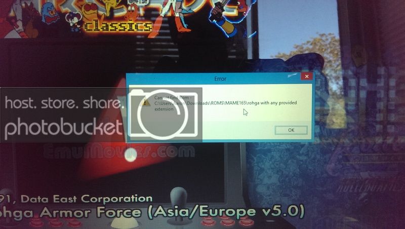

aironeous Posted September 7, 2015 Posted September 7, 2015 So i did the Mame tutorial videos by Simply Austin on youtube to install hypserspin and get it working with mame . I followed them every detail and everything went great until I checked the "roms only" box in hyper HQ for the navigations tab for the mame wheel. He gives a red warning https://youtu.be/P30C0KI-neM?t=4054 that if i was using using hyperspin 1.3 with Rocketlauncher that I will get a known bug that my roms will not be found if i check the roms only box. But when I hover over Hyperspin it is 1.4 so I thought this warning does not apply to me and I did what he did to replace the actual older hyperspin application file earlier in the video with the 1.4. But it does apply to me apparantly because now my roms can no longer be found and I have tried everything I can think of. All my extensions and rom paths are correct. I can lauch individual roms from within Rocketlauncher.
SIMPLYAUSTIN Posted September 7, 2015 Posted September 7, 2015 What exactly goes wrong? Games not showing in RocketLauncher or that they do not show in HyperSpin? Or simply that they do not run? Simply Austin's YouTube
aironeous Posted September 7, 2015 Author Posted September 7, 2015 They won't start anymore. And that is the correct path to the roms and the extensions are in the mame section on hyper hq and I even checked the ini file in hyperspin and everything in it is correct and I can launch roms within rocketlauncher.
aironeous Posted September 9, 2015 Author Posted September 9, 2015 I removed the paths to the executable and roms in HyperHQ and added them back just to see what happens, Now it says I do not have a hyperlaunch 2 module for mame but clearly there is a mame module in the rocketlauncher module directory and rocketlauncher is pointing directly at it. Now I changed the roms locations to where they are expected to be by default under the emulator roms directory. It still gives the same error about no mame module.
aironeous Posted September 12, 2015 Author Posted September 12, 2015 I can launch games from hyperspin through mame but not through hyperlaunch. So no fade in's or anything like that. One time after an attempt I read the log and it was expecting the mame.ahk file over in the hyperspin directories so I amuse it by creating those directories and copying over the file and then tried it and now it gives me this invalid call to function error.
