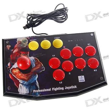

iNTiGOD Posted September 19, 2015 Posted September 19, 2015 But the iPac is a keyboard encoder.... So correct me if I'm wrong but you need to set it up using the keyboard keys. Joystick would be used for something like this https://encrypted-tbn1.gstatic.com/images?q=tbn:ANd9GcQobKRDh7cc3Nq-1_ToIUbF76zof91Hd8z4g3vZXjEnH0MZAKHvbwmT1WT0 Where Windows recognizes the device as a joystick/game pad. Hope that makes sense. MAME High Score Tutorial For HyperSpin
kalleg Posted September 19, 2015 Posted September 19, 2015 Hi again. Ty for your response. We are two posters with the same problem. OP is on ipac. I'm on Xin Mo with usb controller that is registered correctly as 2x joypad.
iNTiGOD Posted September 19, 2015 Posted September 19, 2015 Hi again. Ty for your response. We are two posters with the same problem. OP is on ipac. I'm on Xin Mo with usb controller that is registered correctly as 2x joypad. Ooops I just realized. That's what happens when you write posts in the middle of the night. Yes the xi mo does register as a joypad so it is different. I guess if you are using xpadder you could set it up via keyboard like we discussed. I'm away from my pc atm but will investigate it soon. MAME High Score Tutorial For HyperSpin
