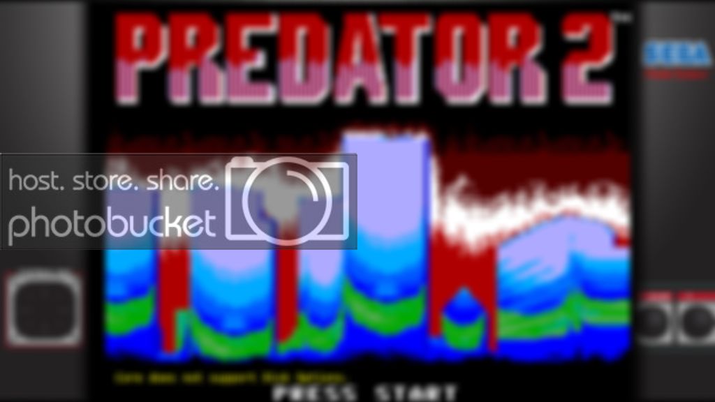

Rincewind Posted October 10, 2015 Author Posted October 10, 2015 Here is the problem... No matter what button I press I get this Yellow text come up.

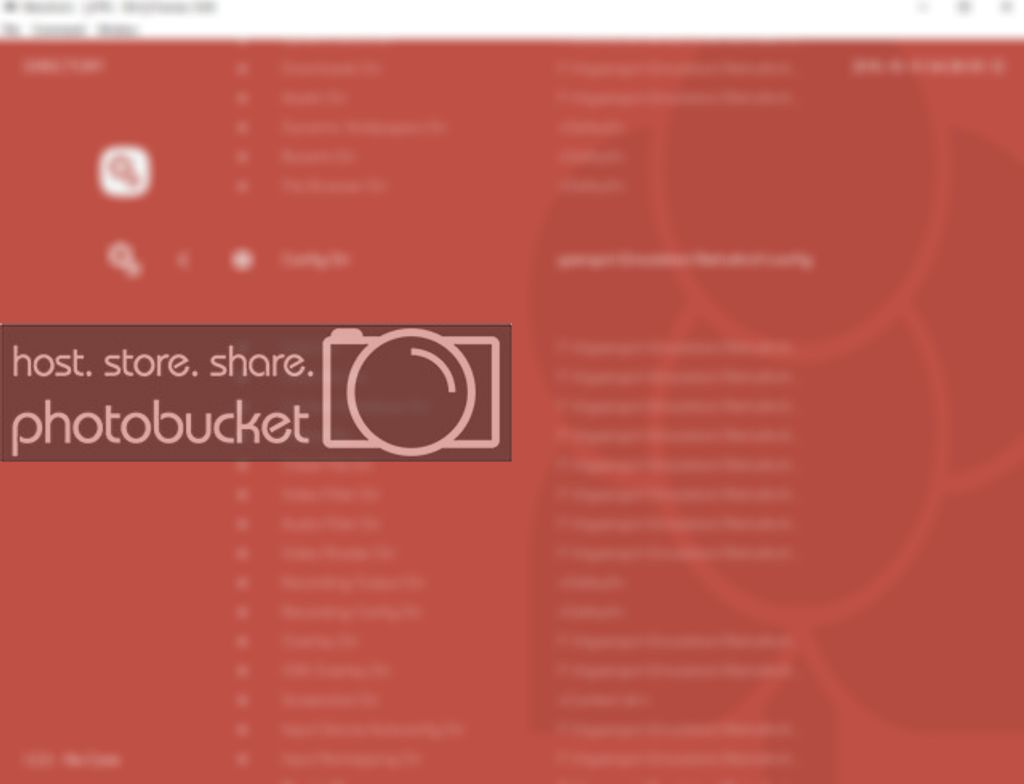

Rincewind Posted October 11, 2015 Author Posted October 11, 2015 This problem just got worse, I was using an old version so I tried to upgrade to 1.2.2 which is now in the Retroarch folder in my Emulators folder, I also transfered my System bios's from the old version I had and I used the new Online Updater to get the Cores... Oh did I forget to mention a fresh new copy of windows 10 arrrgghhh feel my pain now HAHAHA. thinking I have covered everything well no heres the message....
Aorin Posted October 11, 2015 Posted October 11, 2015 On 10/11/2015 at 10:32 PM, Rincewind said: This problem just got worse, I was using an old version so I tried to upgrade to 1.2.2 which is now in the Retroarch folder in my Emulators folder, I also transfered my System bios's from the old version I had and I used the new Online Updater to get the Cores... Oh did I forget to mention a fresh new copy of windows 10 arrrgghhh feel my pain now HAHAHA. thinking I have covered everything well no heres the message.... You have to address Rocket Launcher to your Retroarch config files, you'll have to do that in Rocket Launcher modules configs, under Retroarch module; Aorin

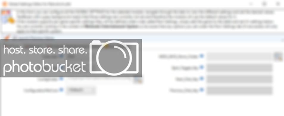

Rincewind Posted October 12, 2015 Author Posted October 12, 2015 Tried that but i got the same error again, here's mine. I did notice my MESS_BIOS_Roms_Folder was not filled in so I sorted that too now but the error is still there.
Rincewind Posted October 12, 2015 Author Posted October 12, 2015 Is there any other reason why I would be getting this.... It seems to be trying to find the file in the ----hyperspin\emulators\retroarch---- main root folder and not the ----hyperspin\emulators\retroarch\config---- folder but I dont know how to change it.
Aorin Posted October 12, 2015 Posted October 12, 2015 Try opening Retroarch again, go under settings, paths and there, put the retroarch config folder in its right place, which should be \Retroarch\Config, exit the emulator and try again Aorin
Rincewind Posted October 13, 2015 Author Posted October 13, 2015 On 10/12/2015 at 10:38 PM, Aorin said: Try opening Retroarch again, go under settings, paths and there, put the retroarch config folder in its right place, which should be \Retroarch\Config, exit the emulator and try again I could see Directories but that was already set.
gigapig Posted October 13, 2015 Posted October 13, 2015 Oh the wows of using an emulator that is under daily development. The current supported version of RA is 05-11-2015, but how can you find that?? The problem with the latest nightlys and RL is the "retroarch-core-options.cfg" file has moved from the root of RetroArch to the config folder and the module is looking in the root for it. I've got no idea what that file does or why the module needs it, you have 2 options, neither are my favourites. Option 1. Easy but not overly recommended. Find the "retroarch-core-options.cfg" file and move it to the root of your RA folder. If you can't find that file it's only generated when you run certain syatems from within RA. Nintendo 64 (Mupen core) will generate it, Atari 2600 (Stella core) won't. Option 2. Slightly harder and slightly more recommended. Open the RA module in Notepad++ Either search (ctrl-h) for "retroarch-core-options.cfg" or it may be line 332 and you will see. Quote coreOptionsCFGFile := CheckFile((If configurationPerCore = "true" ? configFolder . "\retroarch-core-options.cfg" : emuPath . "\retroarch-core-options.cfg"), "Could not find retroarch-core-options.cfg in retroarch directory: Change the above to this. Quote coreOptionsCFGFile := CheckFile((If configurationPerCore = "true" ? configFolder . "\retroarch-core-options.cfg" : emuPath . "\config\retroarch-core-options.cfg"), "Could not find retroarch-core-options.cfg in retroarch You can see I have added the extra folder above (\config.) Save it and that should go away as long as the config file is in the correct place. My current problems with most systems is getting a black screen unless I have bezels enabled
