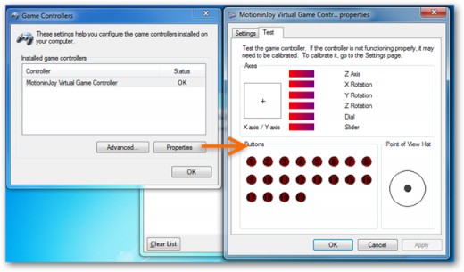

Vanbo Posted October 13, 2015 Author Posted October 13, 2015 When I installed V-joy, x-padder then recognized the keyboard as a joystick. But I'm just going to do what you guys said and map it in the emulator. Much simpler than all that!
Metalzoic Posted October 14, 2015 Posted October 14, 2015 When I installed V-joy, x-padder then recognized the keyboard as a joystick. But I'm just going to do what you guys said and map it in the emulator. Much simpler than all that! Just a tip to save you frustration later. Careful with Vjoy. Just having it installed can make many other games and programs not work right or not work at all. For example the AAE emulator won't even launch when VJoy is enabled. Broforce (and several other games) game won't run. Some will work, but won't control correctly (SSIV). However some won't run correctly without it (Mortal Kombat X). You don't need to uninstall it, simply open your device manager and disable its drivers unless you're playing a game that needs it.

Vanbo Posted October 16, 2015 Author Posted October 16, 2015 Yep, Vjoy started messing me up. I just uninstalled for now, as I don't have any game pads anyway. With my ipac I'm straight keyboard emulation.
Metalzoic Posted October 16, 2015 Posted October 16, 2015 Yep, Vjoy started messing me up. I just uninstalled for now, as I don't have any game pads anyway. With my ipac I'm straight keyboard emulation. Yeah, that's why I warned you. You don't need to uninstall it though. You can simply disable the drivers in Device Manager. It can be super useful, or even absolutely necessary, for some PC games as it makes your iPac register as a joystick/controller.
