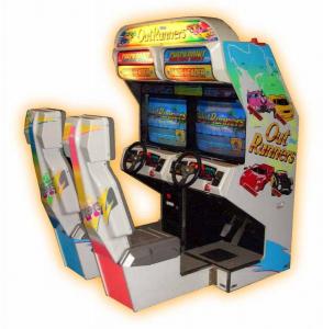

maniacmat Posted May 30, 2013 Posted May 30, 2013 I'm making something a little different in the Wreck it Ralph series and converting my Sega Outrunners 2 player cab into the Sugar Rush Cab, am currently playing with the artwork as there aren't any hires pics of the cab that i can find, my photoshop skills aren't the best but i'm going to give it a go. I have 2 logitech G27 wheels for the cab and i'm looking at monitor sizes, hoping for 27" 3D screens but will have to see how big I can fit in there. I'll post updates as I progress.

maniacmat Posted June 2, 2013 Author Posted June 2, 2013 Thanks for that Rick, after doing some measuring i'm going to have to go with the 24" so VG248QE looks like the one, just have to order them from the states as they are 499 a piece here in oz, maybe I should wait till you do the hard work of the artwork for me I'm making up some extenders atm to retrofit the G27's in the cab neatly, i'll probably get them to make some extra's up, i'll post some pics when its done to give you an idea of what I mean. Mat
