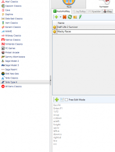

Metalzoic Posted December 10, 2015 Posted December 10, 2015 I don't know man. It should work. Here's something even more weird. I went to capture a screenshot of mine and SShodown doesn't even show up under my Keymapper. It's only showing Wacky Races and Half-Life. However it all works perfectly (P1 & P2) just like when I set it up originally. Really, really weird. Not sure why it isn't on the list. Started, re-started and restarted the PC and it still doesn't show but the game works. Bizarre.
