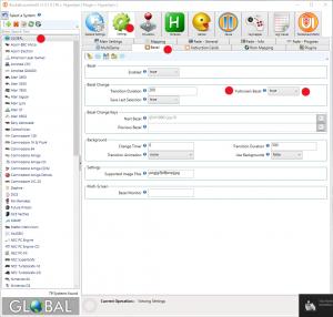

Not having any bezels in the folder is an obvious one.
Having "Full Screen" bezel set to "true" may cause it but hitting your bezel change key should bring a bezel up.
Not having the bezel or ini file named correctly.
More detail or an RL log would help.
If you don't have the bezel setting "use last bezel" set to true, then when you run a game the bezel it uses (or if it even uses a bezel) seems to be random.
The very first time you play a game it also seems to be random whether or not a bezel will be used automatically. Often you have to toggle to the next bezel to get one to load.
You need to set the logging level to Troubleshooting and post again, the log you posted is set to level 3 which doesn't have the full details showing.
What bezels are you using for SNES and where are they located?
As gigapig said, disable the extra full screen bezel option on RLUI.
The reason why this happens is better explained here:
http://www.rlauncher.com/forum/showthread.php?2107-Bezels-Not-Working&p=19463&viewfull=1#post19463
When asking for help for RocketLauncher, POST ON THE RLAUNCHER.NET FORUMS!
Also, please post your RocketLauncher.log with logging level set to troubleshooting in pastebin (set the log level in RocketLauncherUI, global system > General Settings -> RocketLauncher).
Ass. Bleasby - RocketLauncher Development Team.
I did have the extra bezel loading. It seems to be working at this time. I had to turn off both full screen bezels in the global and emaulator settings to make this work. Is this the correct way to do it.
If you want the bezel to always show the yes. The full screen bezel allows you to switch to full screen at the touch of a button, if you always want a bezel then turn the feature off, if you want both then set a "Next Bezel" key.

Here you go. Also having "Save Last Selection" set as true will load the same bezel as previously loaded instead of randomly.
Set the hightlighted "Fullscreen Bezel" to false, if you don't want the the game to show as fullscreen.
