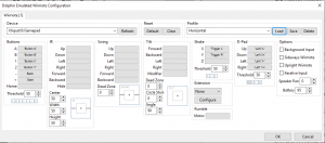

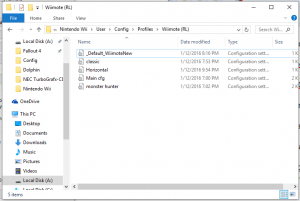

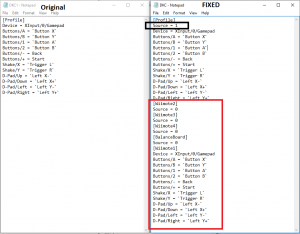

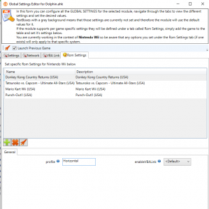

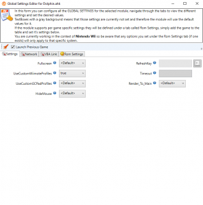

I figure out why the control profiles would not switch over when the module copys over the profile it doesn't add everything in the .ini file needs to work. I have uploaded some pics of what it is missing. also when you create a new profile copy it over to Wiimote (RL) and delete it out of the Wiimote or rename it or you'll have trouble getting it to work.
