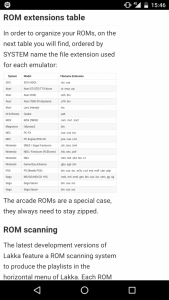

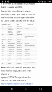

Sting Posted January 22, 2016 Posted January 22, 2016 Put all your BIOS files in one folder, then launch a game through Hyperspin, open the menu, turn off per core setting's, next choose the BIOS folder setting/directory/BIOS go back to the game and then exit Retroarch to save the setting's, try launching Sega CD and other system's that need BIOS files, all should work Now launch a game through Hyperspin, open menu and now switch per core setting's, every system should still have the BIOS directory set still I've attached a couple of helpful setting screenshots for Retroarch
badhemi Posted January 22, 2016 Author Posted January 22, 2016 Put all your BIOS files in one folder, then launch a game through Hyperspin, open the menu, turn off per core setting's, next choose the BIOS folder setting/directory/BIOS go back to the game and then exit Retroarch to save the setting's, try launching Sega CD and other system's that need BIOS files, all should work Now launch a game through Hyperspin, open menu and now switch per core setting's, every system should still have the BIOS directory set still I've attached a couple of helpful setting screenshots for Retroarch wow sting it worked like a charm. props to you.!!!!!! I but all my extracted bios bin files in my hardrive root named android bios and kept all the zipped ones for pc in there game folders. thanks again and props to Jeremy for making me a nice setup and giving me great customer support. thanks guys
