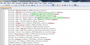

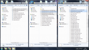

Retro Goonie Posted January 30, 2016 Posted January 30, 2016 This is how I do it...which is why I asked if you were using RocketLauncher. 1. Make a duplicate of the Gambettea core. 2. Name one core "gambetta_game_boy_libretro" and the other "gambetta_game_boy_color_libretro". (Pic 1) 3. Do the same with their 'config' files and 'info' files and edit these files as needed in an editor such as "Notepad" or "Notepad++". 4. Open RocketLauncher. Select Global tab on left and then the Modules tab on top. 5. Go down to and highlight 'RetroArch' and select 'edit in preferred editor'. 6. Change core names to exactly match your newly named cores. (Pic 2) 7. You can now edit your separate cores within RetroArch and have different shaders, overlays, settings for each Nintendo system. Hope this helps! My Artwork! Carts: GCE Vectrex 2D Carts (Realistic Version) 1.0, GCE Vectrex 2D Carts (Vector Version) 1.0 Pointers: NEC PC Engine Pointer(s), NEC SuperGrafx Pointer(s), Sega SG-1000 Pointer(s), Sega TecToy Pointer(s), Sega Mega Drive Japan Pointer(s), Nintendo 64 Pointer(s)
