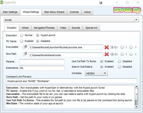

Can I jump in here please as I seem to have a similar problem.
I only have 15 Mame Roms. However Hyperspin just displays loads of games that I don't have. I just want it to display the games within my Roms folder.
I'm running Hyperspin 1.5.1 & under Wheel Settings - Mame - Emulator I cannot see any display Roms only checkbox? Been googling this for a day or so now & can't find anyway to get rid of the other games. Appreciate any helps.

Go to Navigation/Themes and tick roms only
Or just have the wheelart you have games for in your Wheel folder in media, and tick wheels only
