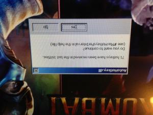

Yardley Posted July 5, 2013 Posted July 5, 2013 I got the error below after playing for a while. Anyway know how to fix this?

Yardley Posted July 6, 2013 Posted July 6, 2013 #UseHook at the beginning of the script seems to have fixed my previous issue.

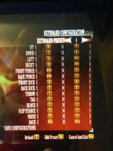

majorspawn Posted July 10, 2013 Posted July 10, 2013 Here's my button config in the game [ATTACH=CONFIG]28397[/ATTACH] why is there 2 buttons assigned for each item for player 1? e.g Player 1 UP is either W or Up key My Arcade Projects: SNES PC Project Vewlix Cabinet LS-30 Rotary Joysticks
Joshuaisarocker Posted July 10, 2013 Posted July 10, 2013 why is there 2 buttons assigned for each item for player 1? e.g Player 1 UP is either W or Up key The first column is Player 1, the second is Player 2. Also, does anyone have an idea what Forward Slash should be named on XINPUT? I tried them together as one word, two words, just "slash", and I still can't get it to work.
