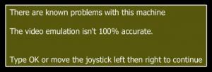

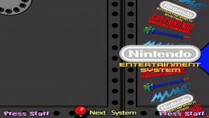

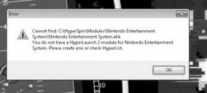

BettyW Posted February 26, 2016 Posted February 26, 2016 I have followed the setup guide here https://gameroomsolutions.com/setup-hyperspin-mame-hyperlaunch-full-guide/ exactly as described in the article. I can see the Wheel and the selected systems I click HyperSpin.exe. I have removed the systems that I don't use and ONLY have Nintendo, Super Nintendo, Nintendo 64 and MAME. When I wheel down to Nintendo and open any game it shows the following error. It does the same for Super Nintendo and Nintendo 64. If I run the ROM from the RocketLaunchUI.exe I get the following error when running Nintendo ROMS I click "OK" and the game opens. When I attempt to launch a Super Nintendo or Nintenod 64 from within RocketLaunchUI and open any game it opens and then immediately closes. I can see a black screen and "Loading" but it quickly flashes closed. I'm running MAME .171b but I've also tried .170 and .166 with the same results. My goal is to have Nintendo, Super Nintendo and Nintendo 64 as the only 3 options on the HyperSpin wheel but use MAME as the emulator. So far, I haven't had any luck. Here's my wheel.
32assassin Posted February 26, 2016 Posted February 26, 2016 ini.JPG Your Hyperspin settings ini is not configured, Hyperspin is not finding Rocketlauncher and is defaulting to using Hyperlaunch 2. You will need to use a more up to date tutorial; their are other paths you need to add to RL. Video.JPG this has nothing to do with Rocketlauncher, Hyperlaunch, or Hyperpsin. Not all roms are emulated at a 100% accuracy, this is a disclaimer telling you that their is something wrong with how the game plays in the emulator.
